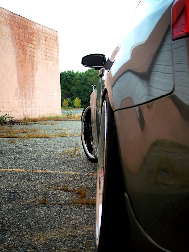

Originally Posted by Silver29
I have a 2006 coupe with the sport package. What is the largest rear wheel/tire combo (offsets please) that will be flush. I also plan on rolling the fenders. Specifically, I would like to use an Avant Garde M310 11" wheel with a 295/35/19 tire. I orginally believed this to be a fairly simple question, but have received countless differing opinions.
being flush has to do with offset and rim width. get that combination correct and you will sit flush. the tire size is specific for ppl going for stretched look, meaty fitment, contact patch, and clearance in the fender.
295s can fit in the rear as long as the wheels they are on have appropriate dimensions. with that said 295s are a regular fit (meaning not stretched or not meaty) for an 11 inch rim. so you will be fine with what you are looking for. fender may need to be rolled i wouldnt go more than a 15-20mm offset for these. see my pics below for a 285 on an 11" rim

vvv pics of my old car... with dimensions front: 20x9 + 35 with 245/35/20
rear: 20x11 +15 with 285/35/20
i was lowered on greddy coilovers, with rolled/pulled fenders.

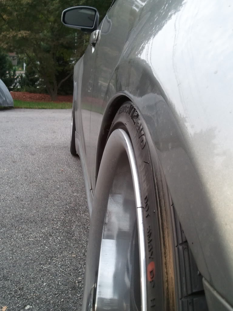

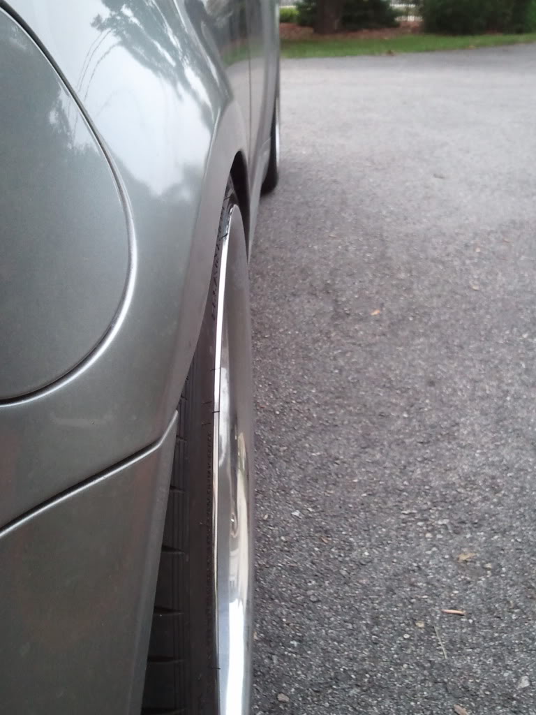

Here ya go!
Currently:
9.5" rim +15 offset with 245/35/19 tire (front)
10.5" rim +15 offset with 265/35/19 tire (rear)
Lowered on Tein S. Tech
The only picture I have, taken with my Iphone. I guess you can Zoom in to see how flush it is.
Sorry I have no idea how to post the picture straight into this reply hehehe
