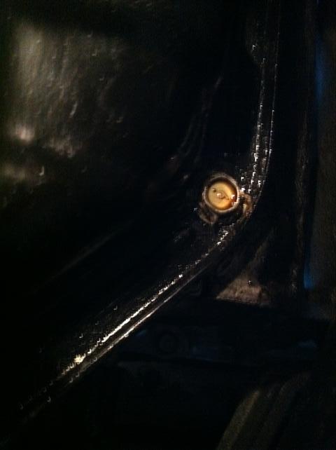

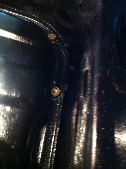

ok so this morning, i opened the bottom up to replace the oil cooler o ring, and also took a closer look.
The oil cooler area was completely dry like, no sign of a oil leak, however i did replace the o ring since i already bought it and there was a Orange one in there, the new ones are black, i take it, it was never replaced.
looks like at some point the previous owner had replaced the oil pan or gasket, because of the gasket is non-factory, 3 bolts were a bit oily but the oil was black so it could be old oil. Rest of the bolts on the oil pan were bone dry.
Question, can i put some high gasket silicone on the 3 bolts if they leak is coming from there, i can only see oil stain if my car sits for more than 48 hours.. Very slow leak
see pics of the 3 bolts on the oil pan.

Some update,
I was looking thru service records and at 87k during routing service, technician discovered oil pan was leaking and infiniti resealed lower engine oil pan. Parts used ultra grey gasket ma-999mp-am003p.
I am at 97k now and i believe the leak could be back, so in this case do i just use a silicone sealant and cover just the holes as mentioned above or redo the entire seal?
any help would be great.
thx

i would redo the pan's rtv. Doesn't sound like the last technician did a thorough job

Originally Posted by trulegend
Some update,
I would just replace the seal/gasket if that is where the leak is coming from. I'm pretty sure they're talking about the little piece of rubber that sits in between the two pans.
