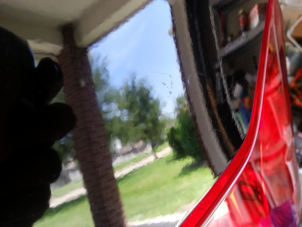

Well here is the damage.... I used my heat gun to warm up the adhesive, then used fishing line to cut the badge off. Got all of them off then used the heat gun again to soften the adhesive and used a microfiber towel to rub off the adhesive. Then polished it the residue off. This is what is left.... I guess 8 year old badges dont come off very nicely...

To say the least I'm pretty bummed. I'll most likely go get it repainted. What a dumb idea this was....

Exact same thing happened to me when i tried debadging 3 years ago...most people don't warn that this could happen...i had mine repainted too because i really didn't want to put the badges back on

repaint??
just take it to a pro detailer

You can't just detail those spots out.
If they're anything like what happened to my car, when I took the Fuji emblem off, there were abrasions right through the clear coat, down into the primer all the way around the edge of where the emblem had been.
My best bet is that dirt and contaminates get up under the emblem, and eat away at the paint.

^^do you not see the change in surfaces on the INFINITI part?? thats not something that a detailer will be able to get polish out....there are indentations into the paint and not stuff just over it

Defiantly needs a respray

Yea its clearly scratches. You can feel them. It will need new paint for sure.

You also have some weird halo oxidation on the Mt. Fuji emblem that I did not have
