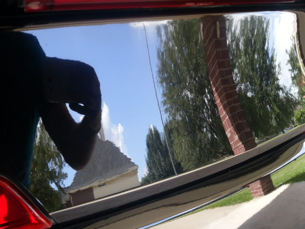

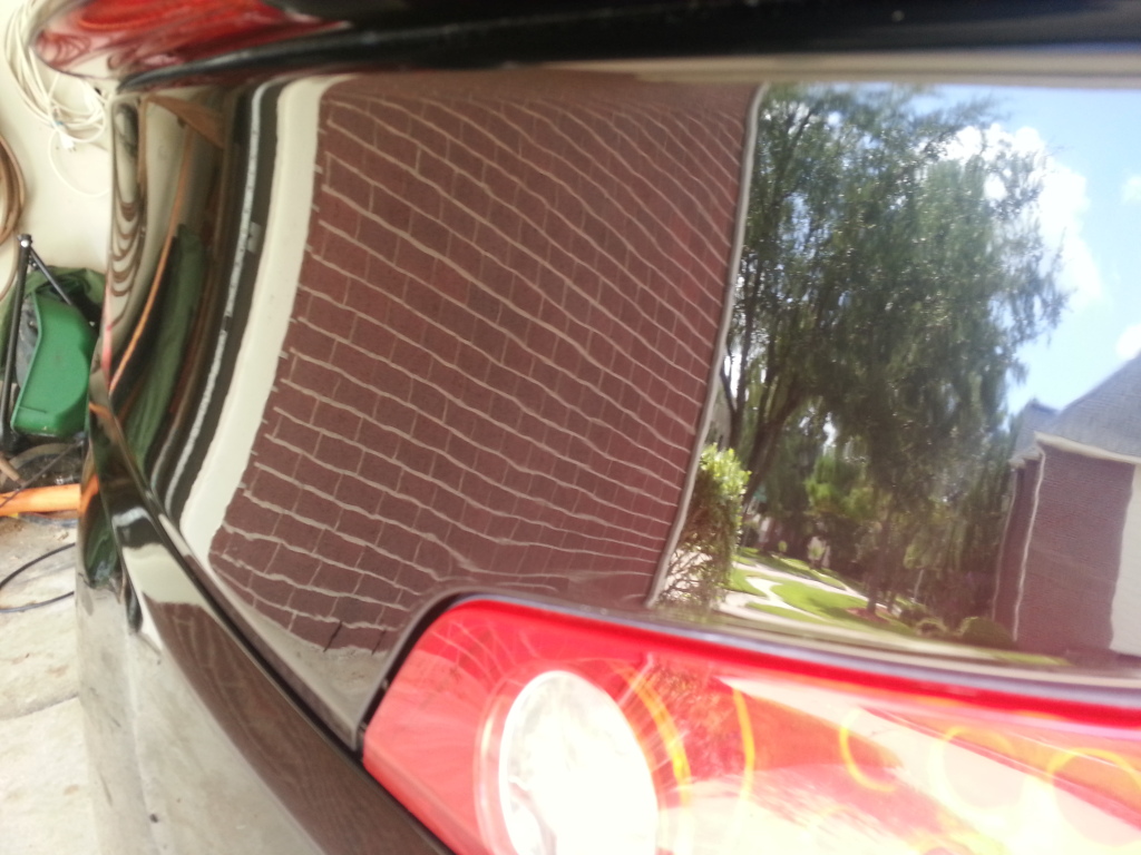

All done... a little un happy..... when I got there was some over spray on the rear bumper and on the tail lights.... But they got most of it off.

Unhappy why?
That's a decent-looking job. Smoother than the OE trunk paint, honestly. I'd give it two weeks or so to bake in the Texas sun, and then lightly wet sand with 2000 grit paper, and give it a good buff and wax to make it really look nice.

The paint is good. but they got over spray on the my taillights. I was able to get it off.

^cus u vouched for them so highly and they left u with mistakes no highly professional shop wouldve made and now u are dealing with it

Overspray on the tail lights isn't that big of a deal...it's easier to get overspray off of plastic parts than it is other paint.

It's all good. It's a clean job. I guess Ill go some where else next time.

Same exact thing happened to my OB ....2000 grit sandpaper till its gone, medium compound to take out sanding scratches, polish then wax. Came out perfect and only 20 bucks for supplies.

What a big difference paint makes! Looks good debadged now. Never seen paint in that condition after a debadge though.
