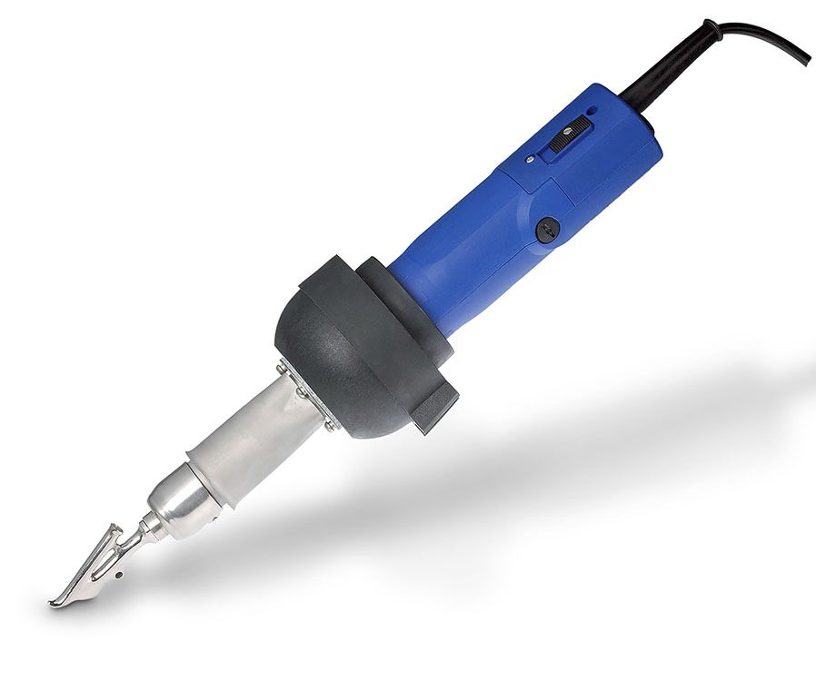

Take dash off, get a cheap plastic welder from harbor freight, weld it from the back side.
I plastic welded my front lip to my bumper on my G37, trust me it holds.

Soldering iron will do the job as well if you don't want to spring for the plastic welder. Some filler helps
Basically you just melt the crack back together. But you gotta do it from the flipside
