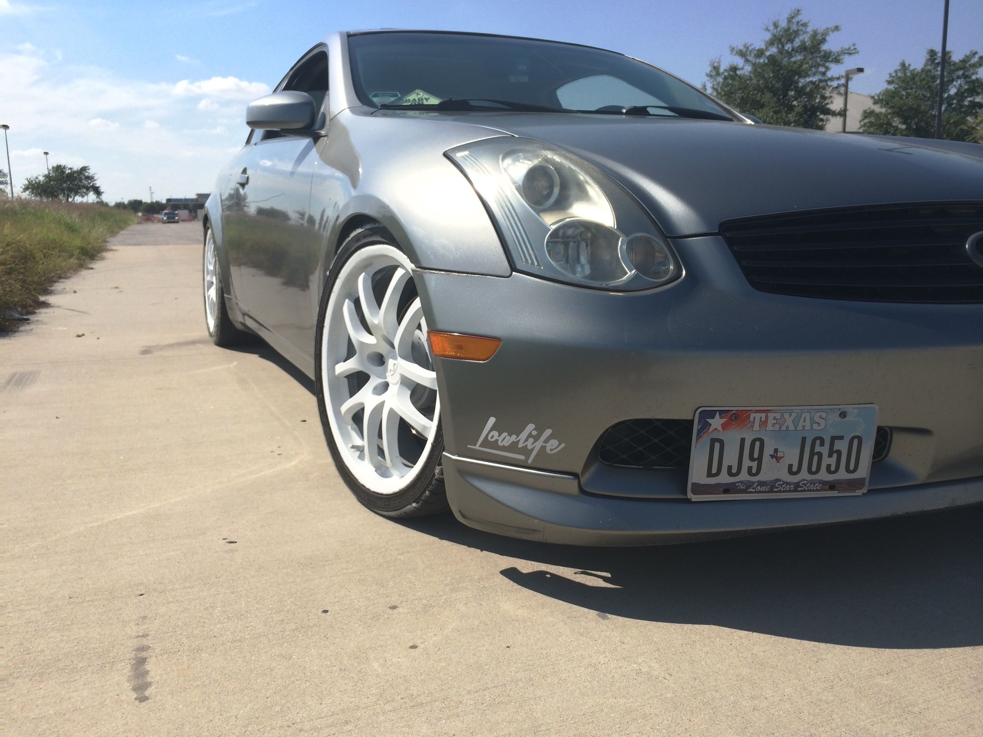

I'm on H&R springs and the rest is stock suspension
So you have just those springs and all stock everything else? More pics??? I think I'm going to go pro kits so I can survive these Houston streets lol
