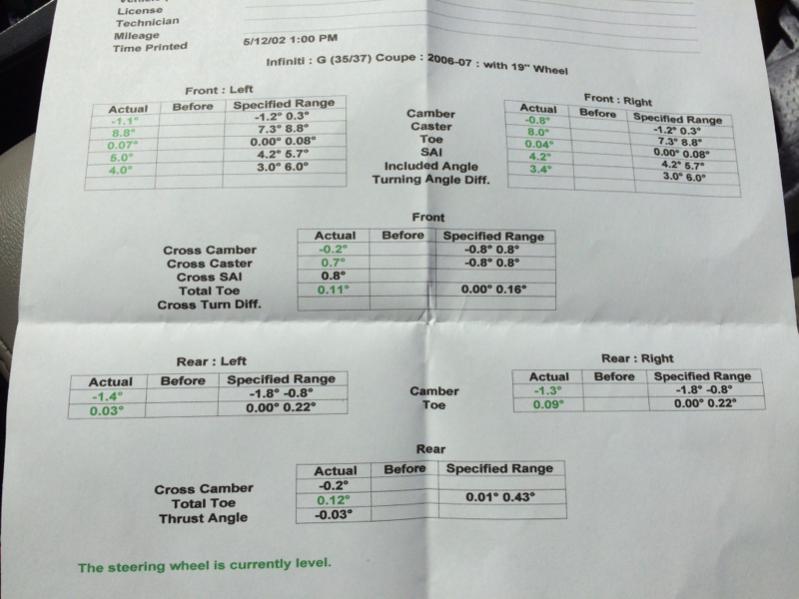

From: Southern California
Here's my alignment specs with oem rear toe bolts. Dropped on Z S-techs. Your front and rear toe will be fine. I guarantee it. If you drop below 1.5" then toe bolts will become necessary. Any less then that you'll be fine.
Hmm..I'm dropped 0.8 in the rear and I needed them. I got a separate alignment after every single suspension mod.
And like I said, your rear toe is maxed out. It should be around 0.32 not 0.12. Just cuz something's in range doesn't mean its optimal.
i have an 06 sport suspension. That may be the difference.

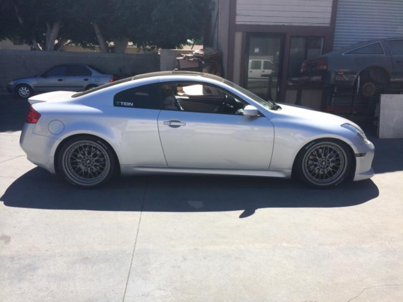

Pic of z s techs? I guess I'll just get each part as needed.

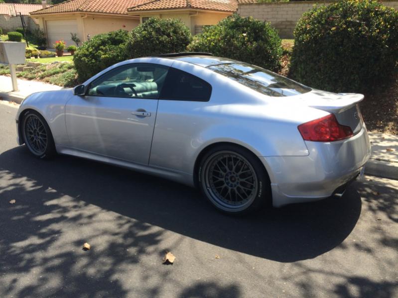

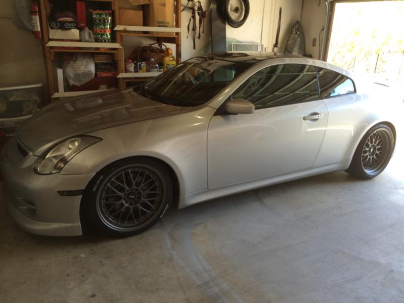

Here u go
Here u go
Lol, did you chalk the lettering on your tires?

Paint
