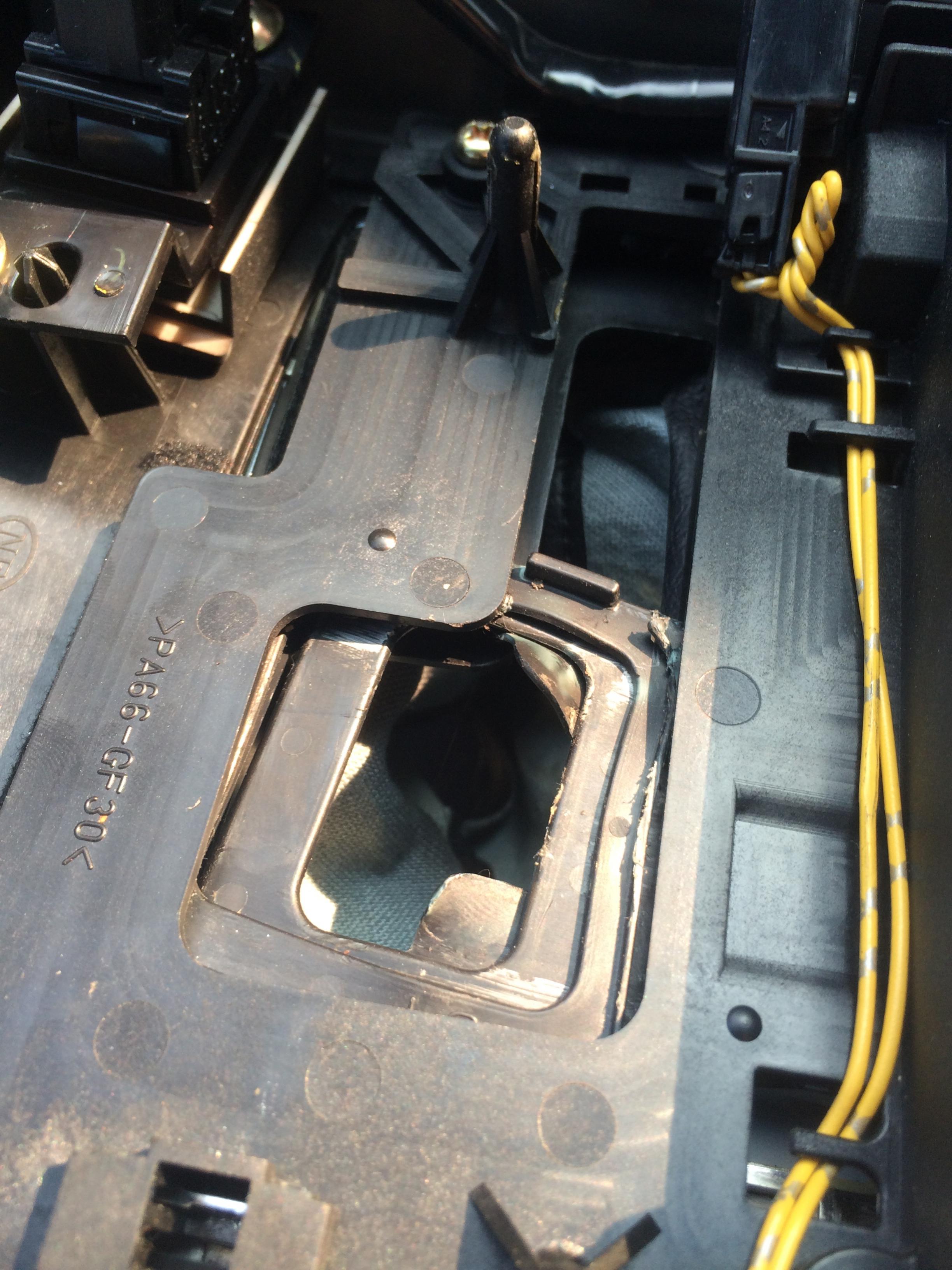

Old Jun 10, 2015 | 07:37 PM
Patrick Bovee's Avatar
Joined: Feb 2015
Posts: 208
From: Long Island
Hard to shift into Park and Reverse
Ok so I took it off and it looks like the plastic sliding price is broken. Any tips on fixing them
Old Jun 11, 2015 | 09:08 AM
Mustang5L5's Avatar
Posts: 8,818
Likes: 468
From: Taxachusetts
Hop on Ebay, and search for a shifter trim for sale. Grab a cheap one with scratched or peeling aluminum trim or a damaged shift boot and just remove the gate part and swap it over to your shifter.
