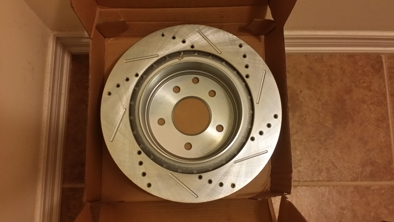

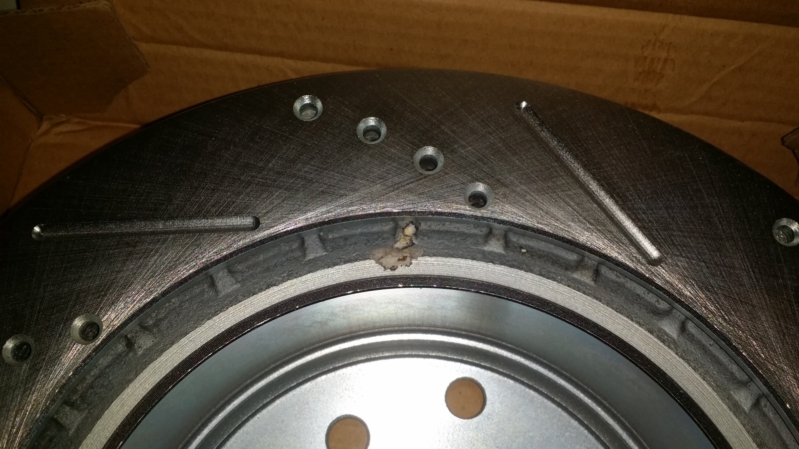

My rotors came in with a small damage done on the rear right rotor. It looks chipped but its actually a smooth surface. I was wondering if it's worth the trip to exchange for another one?

Not worth the trip. They would probably laugh at you for making a big deal about such a minor thing on brake rotors considering it's not even on the useable surface of the rotor.

Hey bud you pay for new rotors. That is a defective one. Yes it's worth the trip to go get it replaced. And if someone laughs at you remember is your money paying for that rotor not theirs.. That rotor can eventually develop a crack..

It is a personal call. You didnt pay for defective rotors, entirely within you right to request unblemished. Also, as stated, the chip impacts nothing.
It is indicative of a casting flaw, not post processing. Which could mean bad cast and be prone to cracking, or it could mean nothing more than a small cosmetic flaw. Who knows.

It' your call, I don't think it will affect performance, BUT, damnit you paid for new well cast/machined rotors. If you haven't removed your old ones yet, I'd replace it.

Thanks for the suggestions. I most likely will exchange for a new one.

Has hole for parking brake adjustment. That's a rear rotor

Originally Posted by matt0323
I'm guessing its the rear.. The rears are smaller than the front right?!
Correct!

A quality manufacture wouldn't have let this rotor out of the warehouse! That's a casting defect even though it might not effect the life of the rotor...return it!

It is an indentation in the rotor or just a blemish on the finish of the rotor?
Cant tell on the pictures and based on you'r description.
If it's just blemish in the finish, I would not worry about it. If it's is actually indentation in the rotor, then it's worth the concern.
