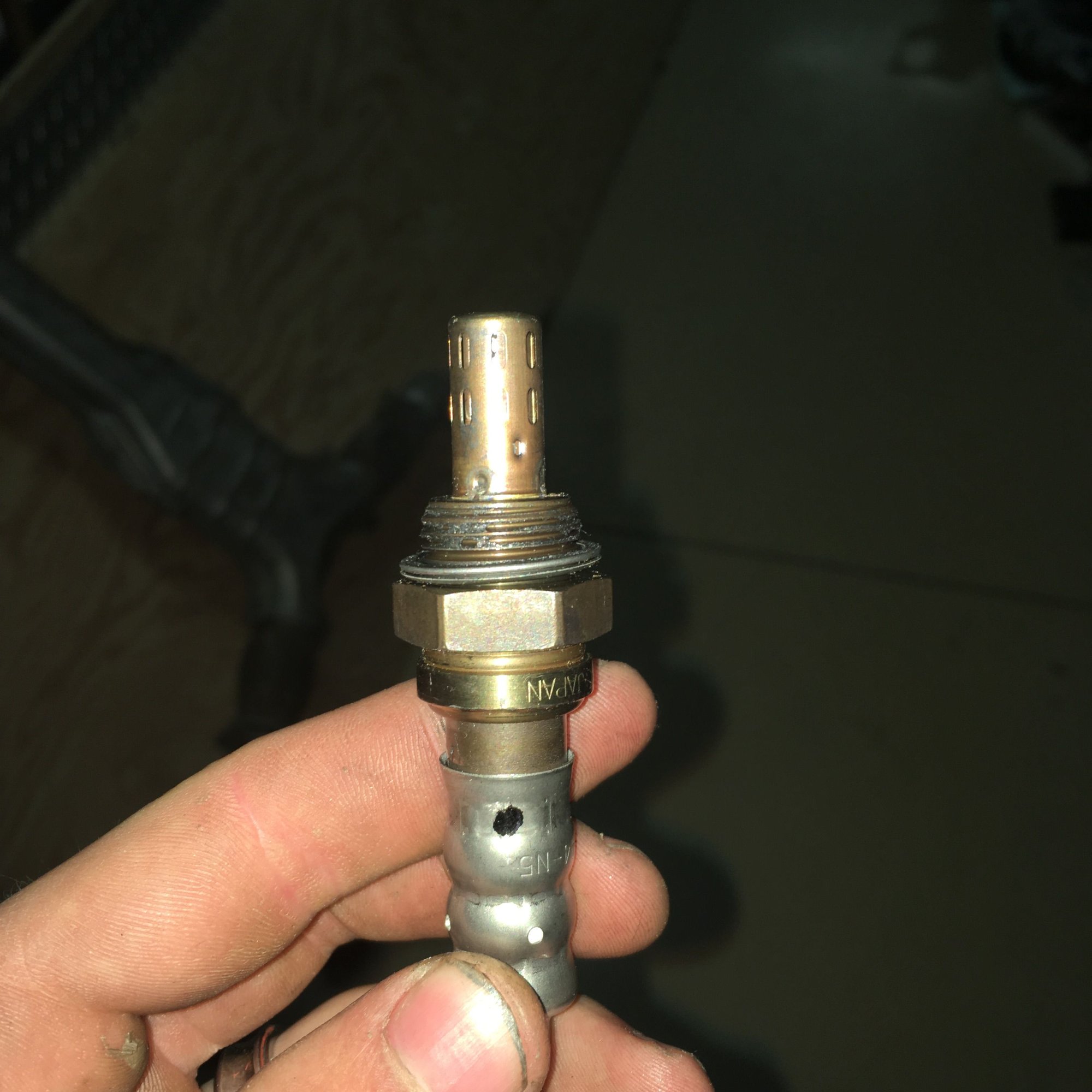

What's up guys, I own a 2004 G35 Coupe 6-Speed with Premium Package. I'm currently rebuilding the motor due to a spun rod bearing and needed to replace my upstream drivers side o2 sensor. I ordered an oem upstream o2 sensor for the 2003-2004 vq35de (Nissan part number 22690-al600) however the sensor is different and the connector is all wrong. It matches the rear o2 perfectly but not the front one I removed. Here's the part I received:
And here's the sensor I removed from my car:
The front one I removed has 5 wires and a 6-prong connector. It is the same way on the harness and appears to be that way from the factory, not spliced in by someone else. Does my car have oem widebands in the front?

In mid 04 they switched the front o2 sensors to what is called a Air/Fuel ratio sensor that is a 6 prong connector. That is where your difference is.

The one u received is a narrowband.
Widebands have 6 wires atleast.
