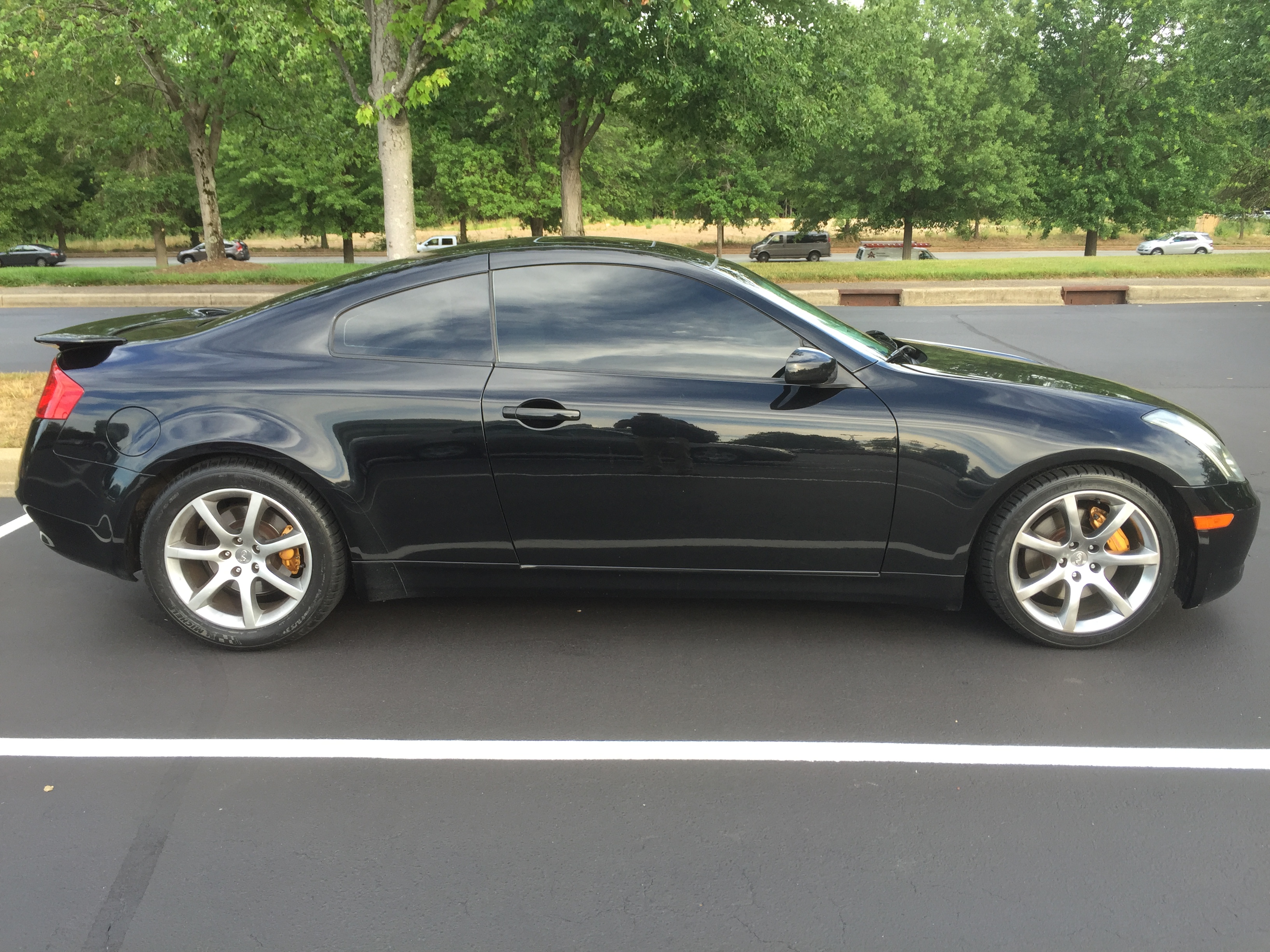

Install complete. Turned out perfect!
The Z front shock assembly is about .5 shorter than the G, and thats exactly the drip I got up front
The Z Rear springs were about .25" shorter and again that was the drop I got initially before cutring off another .25" to get an even stance.
The ride quality is muche better too, since I went from 100k miles suspension to 30k mile suspension.
Now I will need the 25mm soacers to get it looking right.
