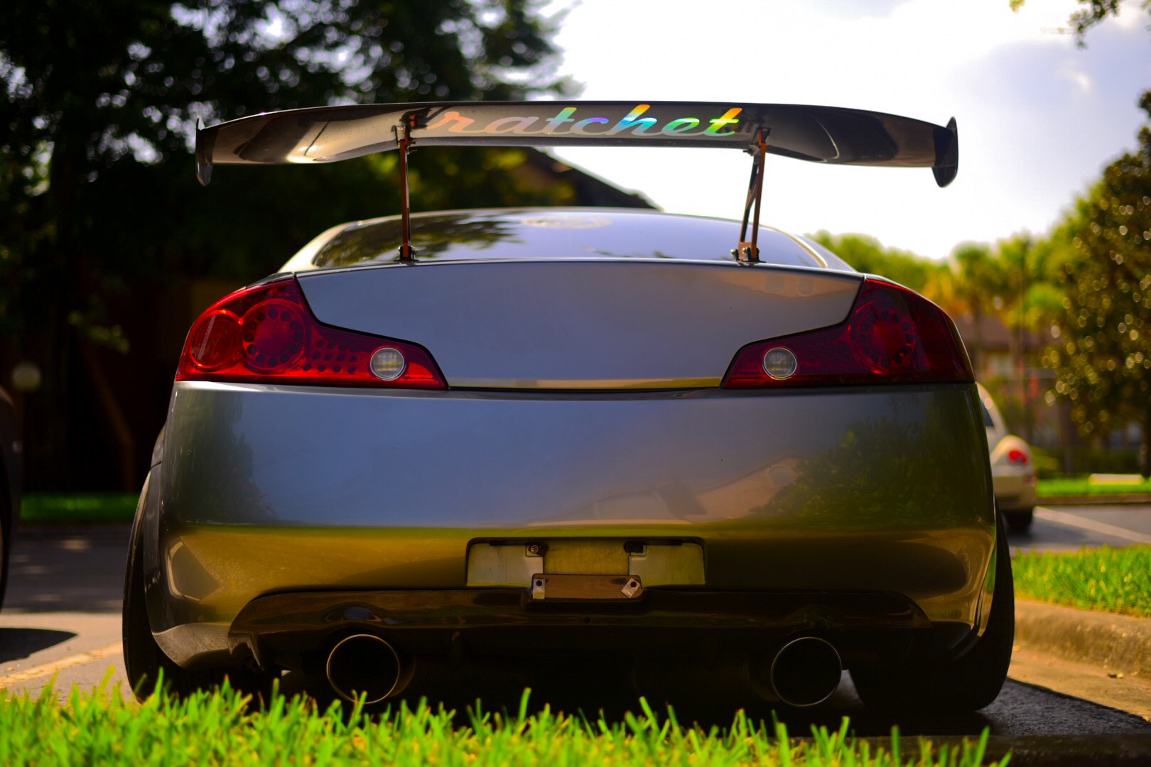

Hello guys I have an 05 Infiniti g35 Coupe with 113,000 miles.
All was well until one day the G started misfiring heavily and went into limp mode. Thankfully my parking spot was 20 feet away, and at that point I parked her and she sat there for months until I had time to diagnose.
----------- months later --------------------------------------------------------------------------------------------
put new gas in and right before giving up she started back up, but was in limp mode, couldn't get over 10mph or 1500rpm.
a week or so later I brought the G to a local mechanic who then told me my timing chain was broken... lies
I then towed the G back to my garage and began my own diagnosing...
changed:
spark plugs (found oil in 4 and 6 assuming it's the valve cover, planning to change this week)
Crank position Sensor
PCV
Oil change
Full tank of high grade fuel with Lucas fuel injector cleaner
Clean MAF
checked for vacuum leaks with a stethoscope (none)
At this point she was running again but would misfire at various rpms, but not without load.
I didn't know what to do next so I took the G to infiniti for guidance.
They ran a diagnostic and returned to me with two codes that they presumed to fix the misfire.
p0345 Camshaft position sensor bank 2 and
p1283 upstream air to fuel ratio o2 sensor
and also a code for the spiral cable.
I went to the auto parts store and bought the two sensors, both OEM and then proceeded to install them.
After installing she started up well and sounded good in park, but as soon as I put her in gear she misfired horribly. It sounded like marbles being dropped into a tin can.
Then I checked the spark plugs and all were clean but 4 and 6
changed coil packs for 4 and 6, but the symptom continued so I then swapped the old CPS back in and the misfire code went away but this misfire did not. but new codes appeared.
P0345 CPS
P0037 Heated oxygen
P1065 ECM backup circuit
my thoughts are it could be the fuel injectors, fuel pump/filter or the ecm is bad. another theory is that one of the resonated pipes on my exhaust has deteriorated inside and causing restricted flow and a bad reading for the o2 sensors.
Where should I start or should I go back to infiniti...
any input is appreciated. thank yaa
