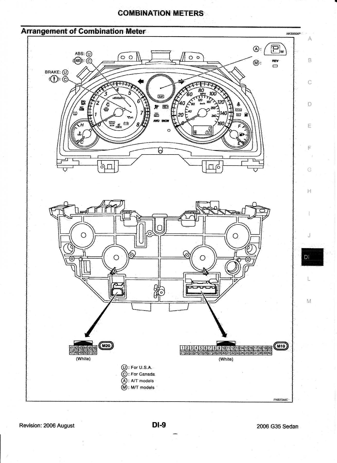

If I get a non rev up 6MT cluster will it plug and play with the AT harness? I still have the AT harness and ECU, however it was tuned for my MT swap. I need a new cluster to fix my fuel gauge and some missing lights, and I just want to know if the AT cluster plugs are compatible with the MT cluster.

I'm PRETTY sure it was all the same, Google search a picture of both and see if the plug is visually similar. I think it would work just fine but you wouldn't have anything displayed on the gear indicator.

I found this diagram and it looks like the plugs are the same either way because it doesn't specify an "A" or "M". That being said I'm curious to see if the pins are the same. I'd think the MT will have a blank where there gear indicator is, hopefully there's no specific MT pins in the cluster than aren't wired in the AT harness.
