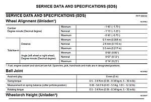

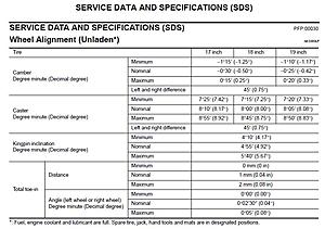

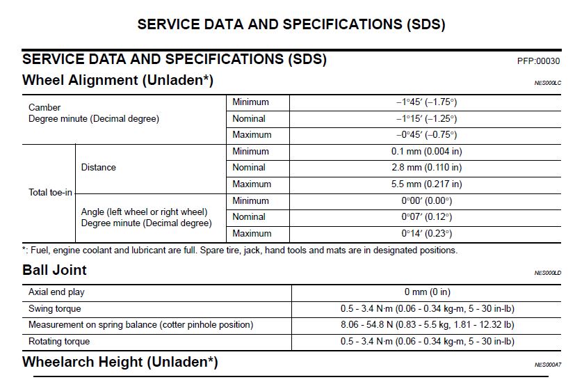

The front you want set at 0.04" left and right for a total of 0.08. This is the maximum value in the FSM but there was a Nissan TSB for Z/G cars to set front toe at max to prevent tire feathering. Rear I think I'm at... 0.07 for left and right, this G is just a highway daily driver right now. FSM has a much broader range of rear toe, just make sure you're symmetrical on both L/R sides.
