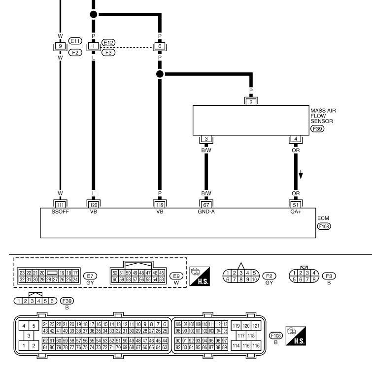

That's the part I don't understand, the MAF has 2 screws that hold it down to the housing, there's no need to replace the whole plastic housing you just swap out the MAF. The ECU will immediately recognize the MAF and clear the P0102 or P0103 codes, if you STILL have error code then something is wrong, either bad MAF, open circuit, short circuit.
If you're not 100% sure your friend rang the wires back to the ECU then just do it yourself, disconnect the battery, unplug the ECU harness, check for continuity between pins 51, 67, 119 on the ECU and the MAF harness.

I never really got into the whole social media thing. It's pretty simple to do, grab a digital multimeter and about 10ft of any type of wire, poke the end of the wire into the MAF harness and run the other end back to the ECU harness. Set the digital multimeter to OHMS and touch the two probes together so you see what reading you get, now put one probe on the wire you ran to the MAF and use the other probe to poke into the harness in slots 57,61,119 and make sure that you have the same continuous circuit reading. Rinse/repeat for the other 2 wires. This verifies that the 3 wires from the harness actually go back to the ECU and none are broken.
Next leave the MAF harness unplugged and read from pin to pin across the ECU, 57-61, 57-119, 61-119, this verifies that the wires aren't shorted out against one another.
Now you have verified you have a continuous circuit for each wire (no open circuit) and that the wires aren't shorted. If you STILL have a MAF error code of P0102 or P0103 once everything is hooked back up then the problem is either in the MAF (probably) or the ECU (less probably).
If you don't feel comfortable performing this troubleshoot then just have the vehicle towed to Nissan or a reputable Nissan repair shop and they can do it.
