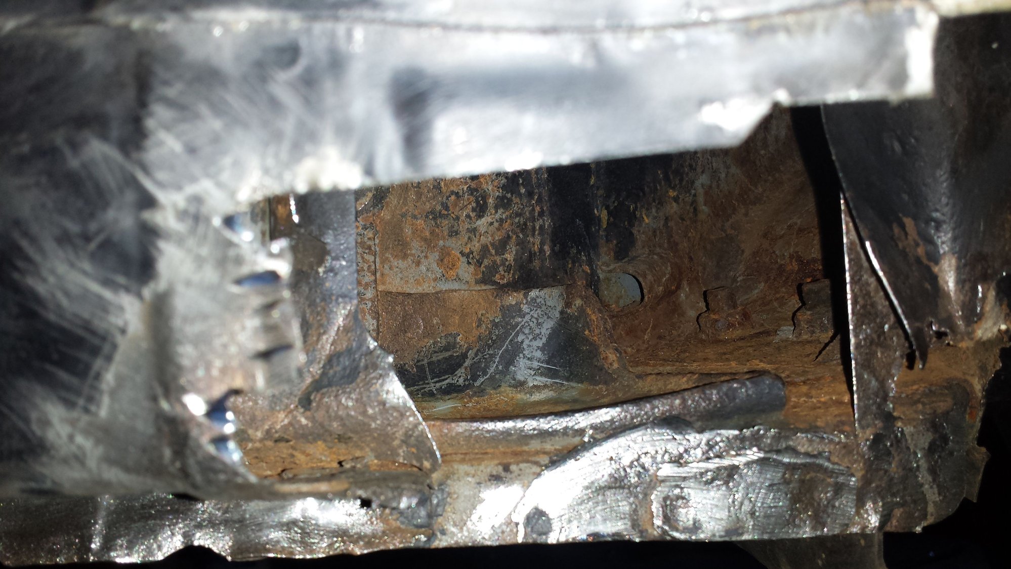

Old Oct 27, 2019 | 01:57 PM
  #22
Matt Wynette's Avatar
Joined: Oct 2019
Posts: 1
From: Cambridge, Ontario
6mt with brembos
Old thread but i thought i'd post some pics of the rust repair on mine so far. $20 in metal and a lot of time invested. This type of repair is very expensive if you can even find a shop that will do it for you. Rust damage is always 100% worse than you think!
