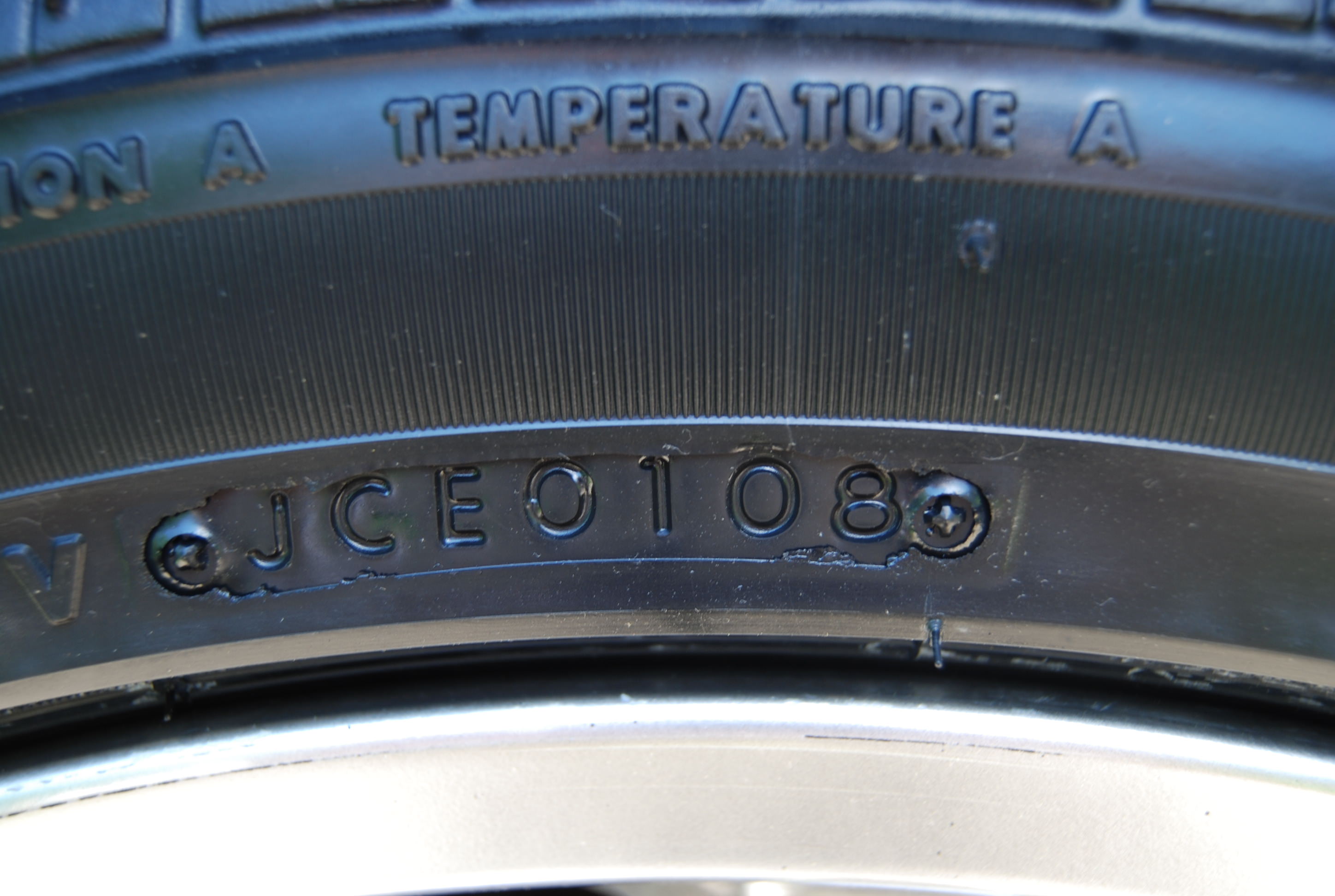

Old Jul 19, 2018 | 07:20 PM
telcoman's Avatar
Veteran: Army
Joined: Mar 2011
Posts: 2,605
Likes: 197
From: Central NJ
Front and rear cameras, tire pressure for all four tires can display on screen,folding side view mir
Check the DOT production stamp, it's 4 digits I side an elongated oval, first two digits is the week and last 2 digits is the year of production. If they're over 5 years old they should probably be replaced. If they're over 10 years old don't drive the vehicle.
In the photo below the tire from my previous 06 G35 was manufactured the first week of January 2008
