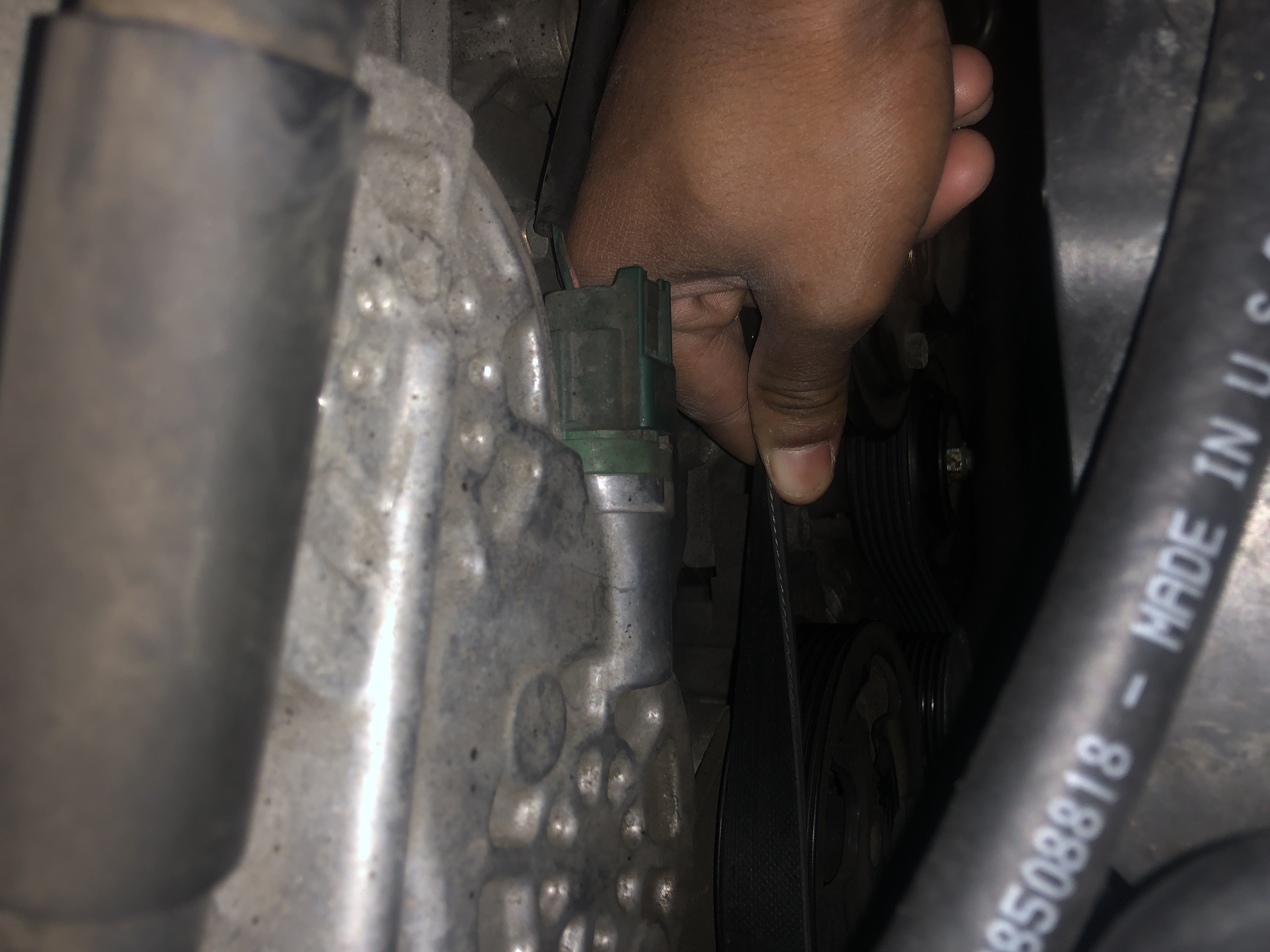

ok so I had some time so I put my sepertine belt on, does it look like it’s tight enough.
I see the picture of it This what I have left from the looks of it I’ll have everything I need.
Do you guys think that this is the shops fault
Attached Thumbnails A/c pulley tensioner fell off-4f399536-8220-4ffa-8d44-b65ff647977d.jpeg   A/c pulley tensioner fell off-d96d08f5-bd0c-43f5-ac0a-bc0e74dcea47.jpeg

It's absolutely the shop's fault. The only way for that pulley to disappear is to not tighten the nut on that bolt. They definitely failed in putting it back together the correct way.
