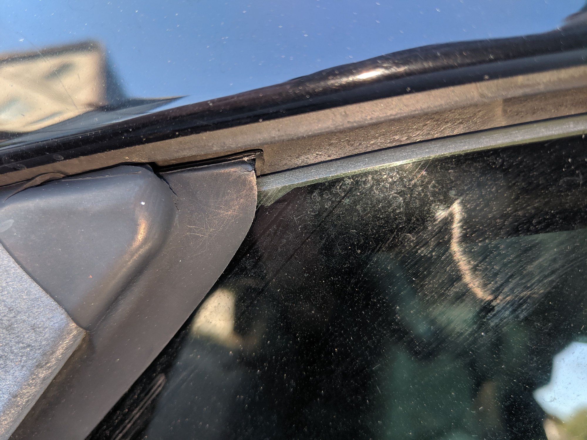

Not sure if u see the gap . Last time I changed the window motor I noticed a gap when I put everything together. I changed the motor again and I have everything apart .
How do I adjust this? Seems like every thing is fixed in place and I don't see many options

I got the gap fixed. If u Google it they say there's 2 nuts where u adjust the gap with a slot tip. That didn't work
What worked for a 03 was the 3 screws that hold the window to the regulator. If u close the window you can get to these screws with the silver panel on. Take off the black covers that seal the holes , loosen those and adjust from there .
Just have to do the reset now
