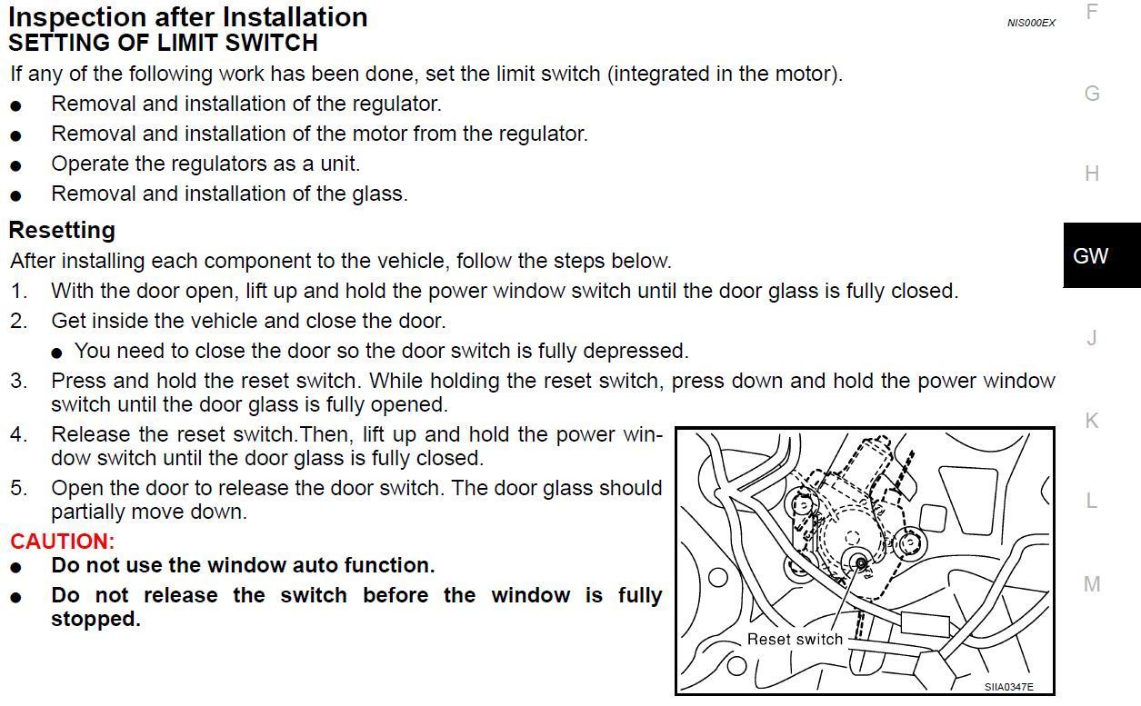

Are you doing the window motor recalibration as well. It's not just the motor that needs to be replaced, you must also calibrate it for the upper stop limit.

After doing the reset my window now goes up about 6 inches and drops down . Can't get it to go up farther

Make sure you are following the directions EXACTLY.

You might have to perform the recal a couple of times to get it to work perfectly.

Yeah the problem is I cannot get it all the way up. I took the motor off and raise the window manually again back to square one I will try again tomorrow LOL

Ok, just make sure you have the door closed and that you are NOT pulling the button all the way back to the second click (auto up).

And make sure you are only depressing the calibration button while the window travels down, then you manually raise the window (first click, not auto-up) all the way to the top and then OPEN THE DOOR. You're programming these settings into the BCM and the input from things like hte door switch are necessary for it to work.
