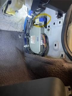

I had the same problem and wanted to add some more detail and say thanks to you guys! Car would shift quite hard when going into reverse, and when driving would accelerate very slowly. It was stuck in 4th gear. A/T light would flash when you started it and check engine line was on. I had a host of codes as well:
P0720 Output speed sensor
P1762 Direct clutch solenoid
P1767 HLR/C clutch solenoid
P1752 Input clutch solenoid
P1757 Front brake solenoid
P1772 LC brake solenoid
P0740 Torque converter
P0745 Pressure control solenoid A
The problem was the TCM Relay (A/T PV IGN RELAY) Inside the passenger footwell behind the panel by where the passenger right foot is there is the TCM. Just above it is the TCM relay which is blue circled in yellow in this picture. I swapped it with one under the hood by the battery that is the exact same part (used for reverse lights) and it solved the problem.
TCM Relay Location circled in yellow

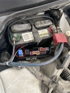

Here is the location of the one under the hood you can swap with to verify. It's circled in red.:
You can test the relay by applying 12VDC (battery power) across pins 1 and 2 and it should faintly "click" and connect pins 3 and 5 like a light switch. You should hear it click and then will have continuity between pins 3 and 5.
You can order off of Amazon or I purchased one locally at AutoZone AutoZone Duralast Multi-Purpose Relay 20279.
