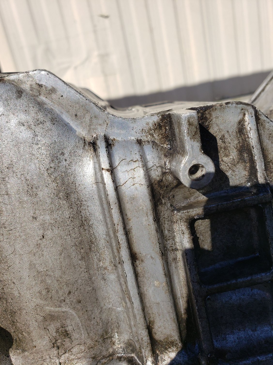

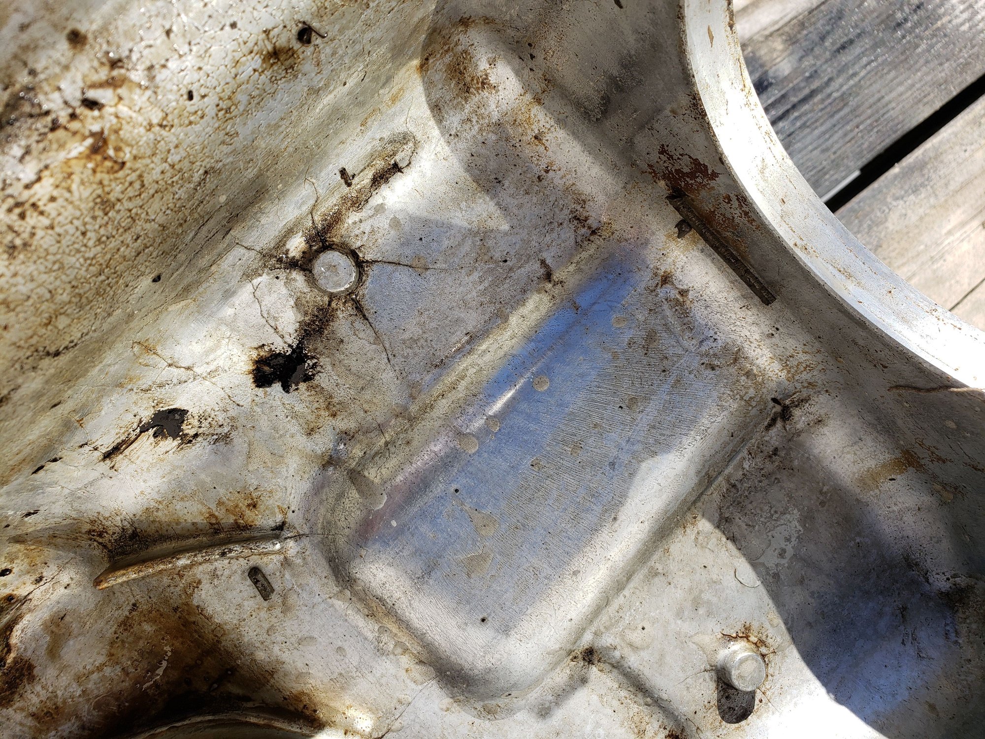

upper oil pan fatigue fractures?
inside pan:
outside pan
There appear to be hairline fatigue fractures at most of the inner form "posts" with some showing on the outside.
There appear to be hairline fatigue fractures all along the pan as well
Is this "normal?
Should I replace the pan?
Are there different revisions of their upper oil pan that are more desirable?
The pan is cast AL5 #1

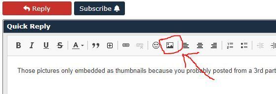

Those pictures only embedded as thumbnails because you probably posted from a 3rd party site. Upload photos directly into the message using this icon.

Looks like casting marks to me, left over from the mould.

I can see the cast marks, or what I would call posts and indents from the form, but there are hairline cracks that seem to come out from some of those marks. And some have those hairlines on the both inner and outer pan areas.
If the hairlines were raised that would be ok to me, but they are not.
I hate to put this thing back on and have it give way sometime down the road.

The aluminum casting looks like this on most of the stuff I have worked on (SR20 & VQ) I wouldn't worry about it unless it was leaking in the first place or a part that was stressed like the AWD upper oil pan after the differential blows up. I could probably take pics all day in the shop and show similar markings.

Looks like die casting flow lines created when the part was made.

OK..I got the new upper oil pan and as you folks said, those are just casting marks, not fractures.
New pan looks exactly like it in terms of casting mold marks.

Usually when mass-producing stuff like that they use permanent molds and those things might have 10k or more castings from the SAME MOLD. Over time the releasing agent builds up in corners and around edges, plus you will always get warping on a steel mold used for aluminum casting. When it gets bad enough that it doesn't pass quality assurance then the mold is recycled.
