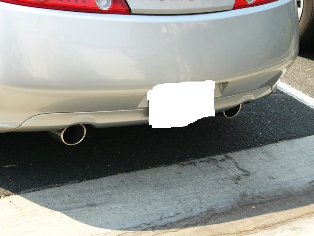

Is this more or less what it would look like with the 6” extension being “recessed”
Old Jan 14, 2020 | 08:11 PM
Ryan_vq35's Avatar
Joined: Oct 2018
Posts: 89
From: Cupertino, California
G35 Sport/Premium Package 5AT
FWIW I just drove to Salinas yesterday to check out a Nismo S-Tune and the guy had an 8" extender on it. Didn't see what it looks like on the G because I had to walk away from it, he said it was in excellent condition and there was a large dent on the top side of the muffler. Just thought I would post this just in the odd chance you were headed that way because he didn't disclose that with me...

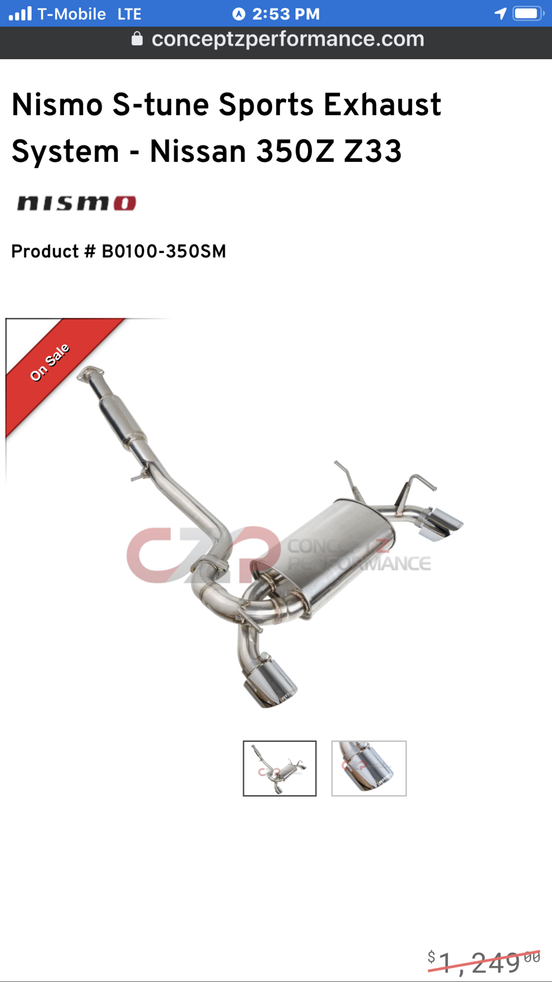

so get the HR pipe and an extension? The 8” one? This is the exhaust I’m looking at
Old Feb 1, 2020 | 03:24 PM
cleric670's Avatar
BANNED!!!
Joined: May 2017
Posts: 14,837
Likes: 2,497
From: Washington State
Coupe 6MT Premium RAS
Whoops I meant an S-Tune y-pipe, not mid pipe, instead use the HR y-pipe, longer primaries and a shorter collector pipe.
I'd call CZP, or message them through their marketplace account here, and ask them whether they recommend the 6 or 8" extension for that setup. Not totally sure how far it will stick out on the coupe.
Do the tips on the S-Tunes normally come welded or do they look like that? That looks like a clamp holding it
Old Feb 1, 2020 | 06:39 PM
cleric670's Avatar
BANNED!!!
Joined: May 2017
Posts: 14,837
Likes: 2,497
Call CZP and ask, that's a generic picture, it would be awesome if they did come that way now so you could get the tips adjusted perfectly to the rear fascia.
