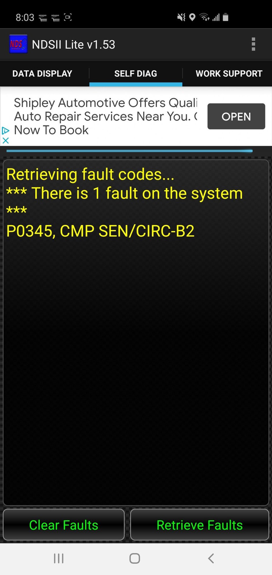

So went to start this car this morning and it wouldn't start.. I pulled out the bafx reader. And here's the pic and results.. the p0011 and p0021 are reoccurring I had this code when I first bought the car and they were from A1 auto. I see the ecm code.. does this mean I'm screwed?

Coupe 6MT Premium RAS
You will occasionally get the P1065 just from disconnecting the battery, it will probably clear itself or you can manually clear it.
You need to check that cam phase sensor HARNESS AND WIRING. Starting to think you have something wrong with the circuit since it's giving the same issue with two different sensors.
However, the one you are using is not an OEM sensor so... it might have just inconveniently died, you can try putting the Hitachi (the one that's probably factory defective) back in to see if the code will stay cleared even though it probably won't make the car run.
So the P0011/P0021 codes, you replaced the cam actuators yes? They're oil pressure driven so make sure you're not low on oil, that will DEFINITELY cause those cam actuator codes.
So yes I checked both cam sensor wiring harness they both have been spliced in with some ghetto house grey and orange twist on end caps. I took them off and put some real closed end crimps I also put some 3M high temp electrical tape just cause. Also the p0165 I'm almost sure it was because I kept disconnecting and reconnecting the battery to test each sensor I don't think I should have done that. Now as for the P0011/P0021 I did replace the vvt solenoids or cam actuator as you refer to them the first time I got the code and you hit the nail on the head about the low oil. I have a real bad leak underneath the engine. I have bought some Gasket maker and the nissan oil cooler gasket. The oil was stupid low on the dipstick.

You can ignore the P0011/P0021 for now because those can be caused by faulty CMP sensor inputs. Basically fix your CMP sensor issues, and those should clear up.
You've thrown a lot of parts at this and have disconnected a lot of things. Go back over EVERYTHING. Make sure dumb things didn't happen like: intake boot folded under when sliding onto the throttle body, hose that goes from intake to back of valve cover isn't cracked or damaged (basically looking for vaccum leaks), all harness connectors are fully connected, make sure connectors for ignition coils 4 & 6 aren't flipped (super common mistake).
Since P0345 is bank 2, check all the wiring and connectors on the drivers side under the intake (I'd remove it and go over it all again). Check for blown fuses in the IPDM.
After all that, do a basic sensor relearn: ignition on (not started) for 5 seconds, off for 15 seconds, on for 5, off again. You should hear the throttle body open and close. Then try starting. Also make sure battery is fully charged.
As an outlier here, I had those CMP codes come up and it was due to my starter failing. Which is actually one of the causes listed in the FSM.
P0340/P0345 possible cause:
1) Harness or connectors (The sensor circuit is open or shorted) - you've found some poor wire repairs already, look for more...
2) Camshaft position sensor (PHASE) - you've replaced these twice already, look at other causes...
3) Camshaft (INT) - referring to damage to the intake camshaft end. You'll need a mirror or a little boroscope camera to check the end after removing the sensor. Looking for debris or damage of the signal plate on camshaft rear end.
4) Starter motor
5) Starting system circuit
6) Dead (weak) battery
