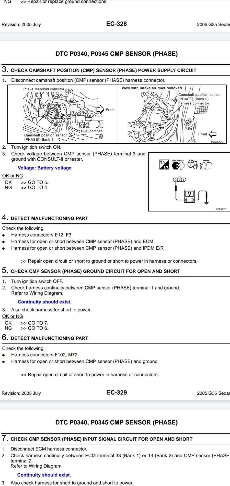

You can order replacement cam sensor harnesses, sounds like you already have aftermarket ones if they're wire nutted on, replace them with new ones, I'm guessing something is wrong with the one throwing the code.
Look up "solder splice connectors" you CANNOT use wirenuts to make up the wiring on those cam sensors, it's never going to last, gotta be soldered together and those solder splice connectors are the easiest to use in tight spaces like that.

Yup basically I'm going to do the oil pan tomorrow morning redo the gasket then I will follow with testing each connector via fsm good thing I downloaded it.

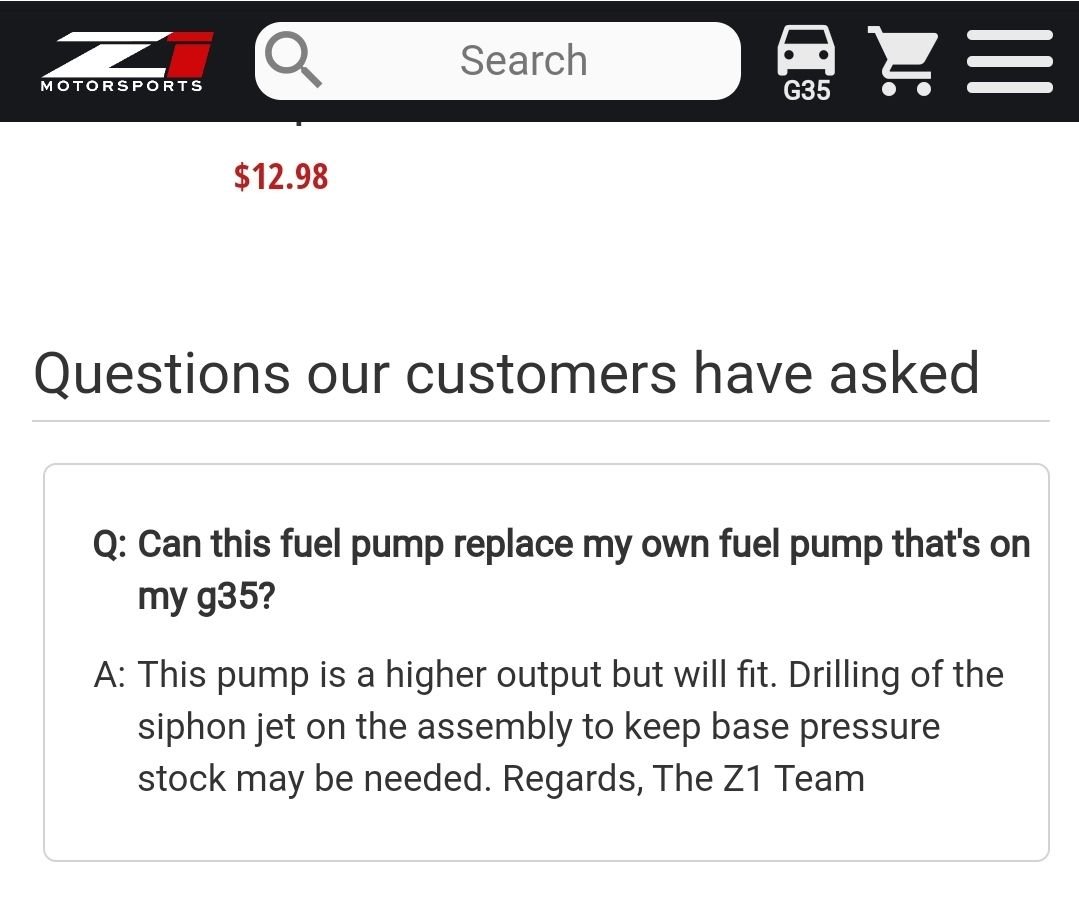

Also I just looked up the walbro 255 it says the fuel pressure it puts out is 81psi won't this be to much for my stock motor? One z1 employee said that its to much and the siphon jet needs to be drilled?

Weird, I didn't have that issue with mine and Z1 never told me anything about it.
Regardless you can pull and inspect the pump and try it without the strainer.

Ok nevermind YES I did modify mine, EDIT: Can't verify what sizes I used. I forgot, didn't follow directions from this site I edited out I'll try to find it later.

Ok sorry for the edits, friends are telling me I almost definitely used the .070 and 7/64 bits like what this website says.
http://www.christurnbull.com/projects/automotive/walbro-gss342-installation-350z-g35-fx35-etc/
ESit: we did this in a parking lot one night when my pump died while on an out of town trip and a 350Z friend just happened to have a spare pump AND the drill bits laying in his trunk so...
Alright thanks for the write up. I already ordered mine so it will be here Friday I will follow the instructions as mentioned.

Also I have the 7/64 bit but I'm having trouble finding a .700 drill bit. Is it 0.70 drill bit or .700?

Same number, the extra zero is redundant
EDIT: You need a .070 bit, not a .700 bit.
There is no mathematical difference between .70 and .700 or even .70000. But that's like almost 3/4" drill bit. I think you're looking for a .070 bit or 5/64" (.078).
What are you trying to fix here anyway? Still seems like you're just throwing parts at this car and hoping for the best. Yes, fuel pressure should be 51 psi, not the 40ish shown in your video. But these cars are a returnless system, the FPR isn't connected to vacuum, so it's not going to move as you rev the engine in your driveway. Cleric has a habit of over explaining/over engineering things without going into possible root causes (love you man!), so jumping into an upgraded fuel pump may not be the proper fix. It may even cause more issues for you. A new pump may be needed in the end, but there's some other items that could be the cause that are simpler fixes. I'm also going to go against Cleric here and recommend you go with an OE replacement pump (Hitachi brand) for the most trouble-free installation.
Crappy wiring (which your car seems to have in general) can cause low voltage to be received at the fuel pump. This would cause a lower fuel pressure. You should at least verify the fuel pump sees 12V or ~14V with engine running. Also something stupid, like the rubber grommet around the output of the fuel pump could be cracked and "leaking" fuel. https://www.z1motorsports.com/fuel-p...et-p-8376.html
