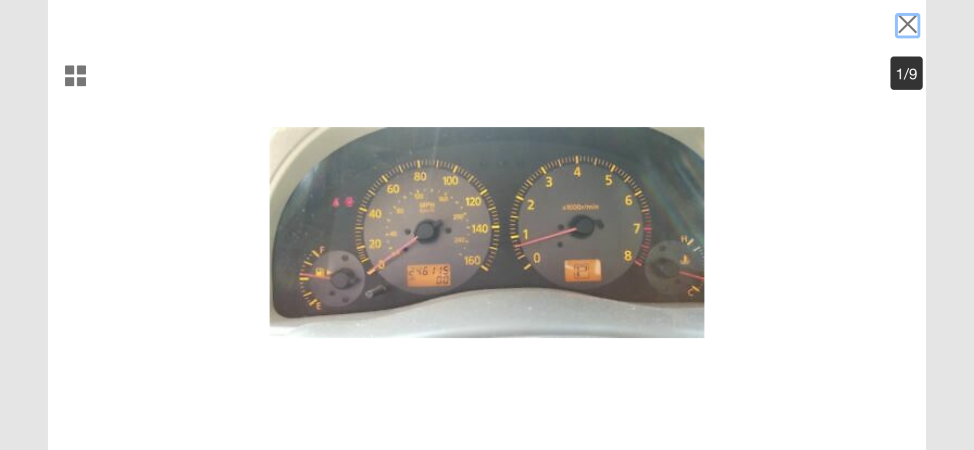

This is the one I have, I’m guessing swapped it from a A/T coupe because the gear indicator is empty, just lights up

Yeah that's definitely the cluster from a 5AT, if your VIN number checks out as being a 6MT then the previous owner must have had the cluster fail and swapped it out with the wrong one.
EDIT: The 2003-2004 6MT cluster doesn't have the LCD screen on the tach.
