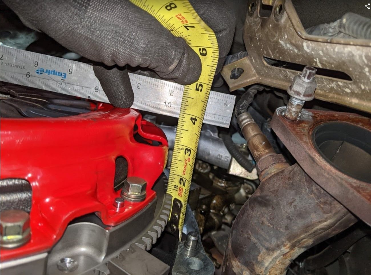

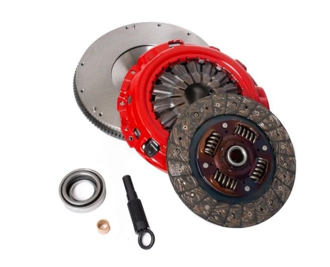

This post will be picture heavy but will give you an idea what all these components look like and how they match together, first photo has a clutch, pressure plate (red with the metal fingers), flywheel, and a throwout bearing, and small brass pilot bushing all laid out. Ignore the plastic splined alignment tool, that doesn't stay installed in the vehicle.

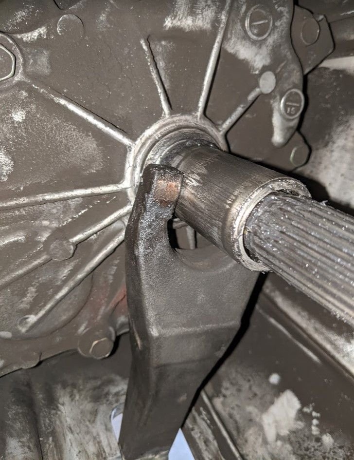

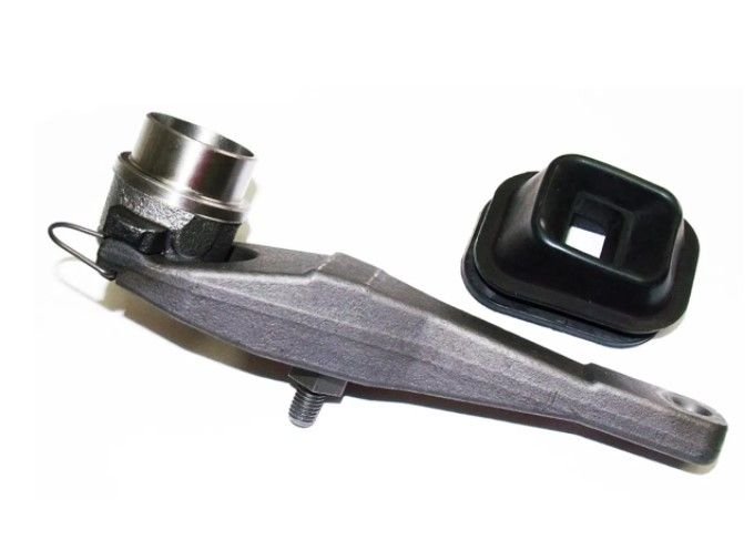

Next is a picture of the clutch fork with a pivot ball (the little threaded stud) already in it, the pivot ball screws into the transmission bellhousing. Also attached to the end of the clutch fork is the carrier for the throwout bearing. The rubber boot fills the gap where the clutch fork goes through the transmission bellhousing.

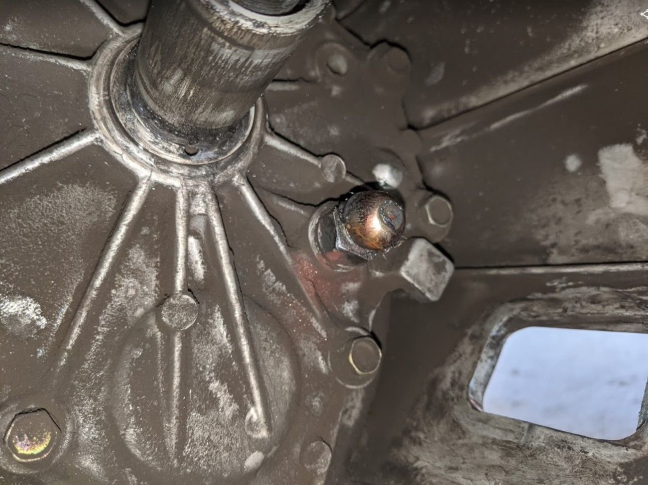

Next is a picture from inside the bellhousing with the clutch fork removed, you can see the window/hole in the bellhousing where the clutch for protrudes outside. The pivot ball is installed into the bellhousing, it's that copper colored piece, the color is the grease/lubricant that is applied to it.

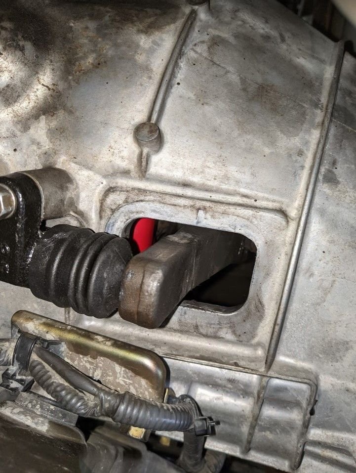

Here is a view from outside the transmission with everything installed but with the rubber boot removed so you can see into the bellhousing, the clutch slave cylinder is that corrogated rubber piece that is attached to the end of the clutch fork.

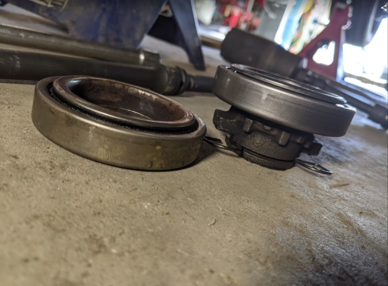

Here is a the throwout bearing, an old compared to a new one that has been reinstalled onto it's carrier housing, this is the same carrier that was shown in the previous picture attached to the clutch fork.
Next is a view of just the clutch fork installed into the bellhousing. You also see it fits around the transmission input shaft which is splined on the end.
And this is what it looks like with the throwout bearing installed back onto the input shaft of the transmission. Ignore the carrier to fork retaining spring that is installed backwards. The carrier bearing rides on the smooth section of the transmission input shaft housing and as you press the clutch it goes in/out along that shaft.

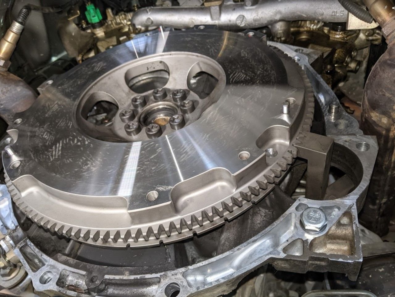

Now we move along to the engine side, first is a picture with just the flywheel installed. Your OEM flywheel looks different from this one, I was installing a lightweight flywheel which is better for performance but a little less "user friendly" and a lot more noisy (clutch chatter). The brass pilot bushing is right in the very middle of the flywheel, it's actually installed in the back of the crankshaft and the flywheel bolts to the engine crankshaft. Once the transmission is reinstalled the very tip of the transmission input shaft will fit into the pilot bushing which stabilizes the transmission input shaft.
Next component is the clutch friction disk, it has an alignment tool installed into it to hold it in place, once the pressure plate it bolted on the clutch will be sandwiched between the flywheel and pressure place with several hundred pounds of force so you use the alignment tool to make sure everything is in the exact location before clamping it together. The clutch doesn't bolt to anything, it floats in the middle of the flywheel and pressure plate, the transmission input shaft will go through the middle of it once the transmission is installed. The flywheel bolts to the engine, the pressure plate bolts to the flywheel so those two components rotate at the same speed as the engine, the clutch attaches to the splines on the transmission input shaft so it rotates at the same speed as your transmission.

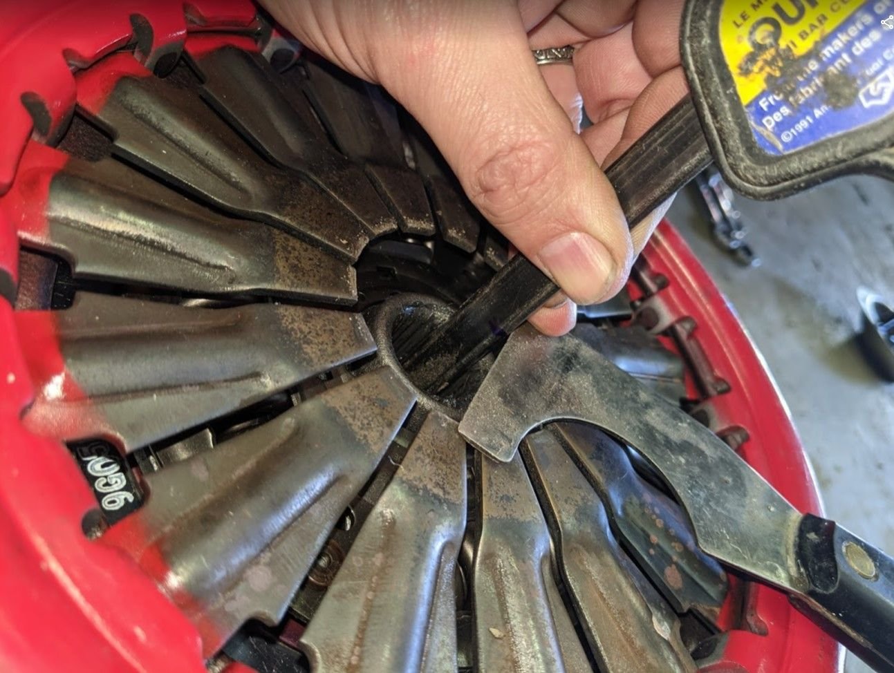

Now we have the final component, the pressure plate, it bolts to the flywheel and the clutch is clamped between the two. Notice all the metal "fingers" of the pressure plate, the throwout bearing presses against these and pushes them in, this causes the other side of the pressure plate to release pressure off the clutch so it can spin freely between the pressure plate and the flywheel.
First photo is a picture of the pressure plate so you can see the fingers, they pivot out near the outside of the plate. If you look closely you can see the clutch friction plate in the very center, only it's metal hub is visible with the internal splines that will mate to the transmission input shaft.
And here is a picture of the pressure plate bolted to the flywheel.
And one final picture of the other side of a pressure plate, it is a smooth metal surface just like the flywheel. As the fingers are depressed the metal plate is retracted backwards a slight amount which takes all the clamping force off the clutch so it can spin freely.
So how it all works, you press the clutch, the slave cylinder extends it's little plunger to push on the clutch fork outside of the transmission, the clutch fork pivots on the pivot ball and pushes the throwout bearing onto the pressure plate with enough force to push the pressure plate fingers in about 1/2" to 5/8" which releases the clamping force from the face of the pressure plate.
The throwout bearing is spinning with the same rpm as the engine while it's pushing against the pressure plate since that plate and the flywheel are bolted to the engine crankshaft and spinning at the same rpm as the engine. The clutch is floating between the two when the clutch is pressed, the clutch is clamped between the two when the clutch is released. The transmission input shaft goes through the center of the clutch friction plate and they are mated together with a splined shaft.
When the throwout bearing fails it's common for it to make a lot of noise but only while you have the clutch pressed in which is making it spin.
This is LIKELY the sound you're hearing but there's always a chance that it's something else, possibly a component that is actually broken not just worn. This is the best diagnosis I can give without actually troubleshooting the car in person.
Hope this helps.
