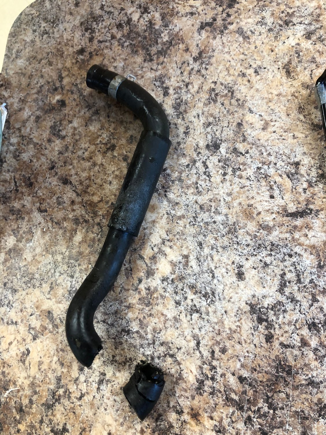

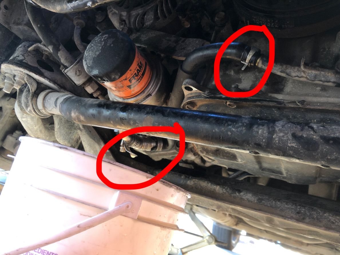

May 10, 2021 | 10:34 PM
[QUOTE=cleric670;7203257]
I think I found the culprit, this hose had a hose clamp way over tightened on one end and it caused the hose to rip and it was barely held together I gave it a lil tug and it ripped apart. Can anyone tell me what this hose is called so I can order a new one? The hose was too short to put back on so I used a coupler and another piece of hose and some clamps to put it back together so it won’t leak but now the angles not right and the hose is a little pinched as you can see in my photo but I think it’s good enough to get home.
Reply 0
May 11, 2021 | 10:44 PM
It's one of the oil cooler hoses, the oil filter screws into a coolant/oil heat exchanger.
