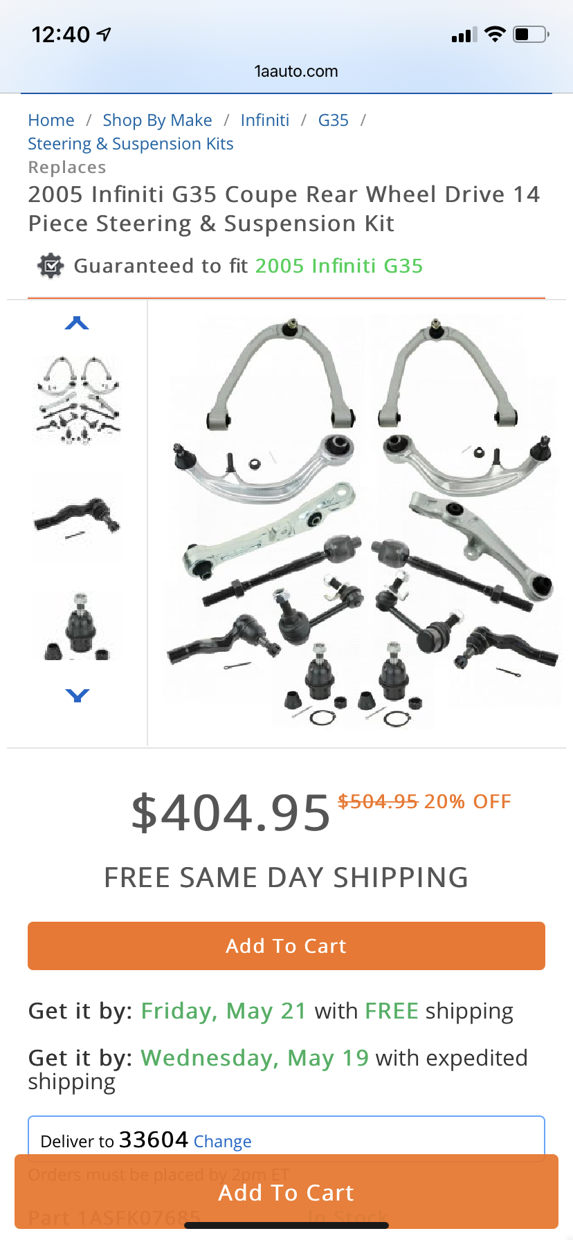

Here are the things that I’ve done to the car so no one asks about them. The front end has all new ball joints, control arms, bushings, end links, rack & pinion and shocks.

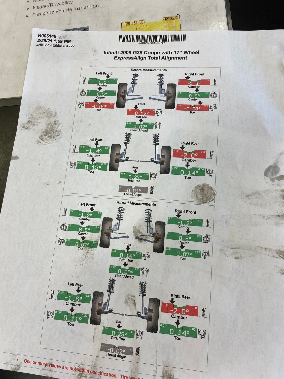

Sounds exactly like it's out of alignment, when did you have it checked, do you have the alignment report? If so take a pic and post it here.

Also, the alignment needs to be fixed/checked anytime you replace a front end component.
I have an appointment set for this upcoming Saturday. Although I don’t think it has to do with the alignment one bit considering I’ve had multiple done after the front end replacements and other stuff. I did just change out the back right upper control arm and the camber arm due to a problem showing up the last time I went.

Yeah your car definitely shouldn't be pulling with numbers like that. You say the R&P was replaced, what about the inner/outer tie rod ends?
