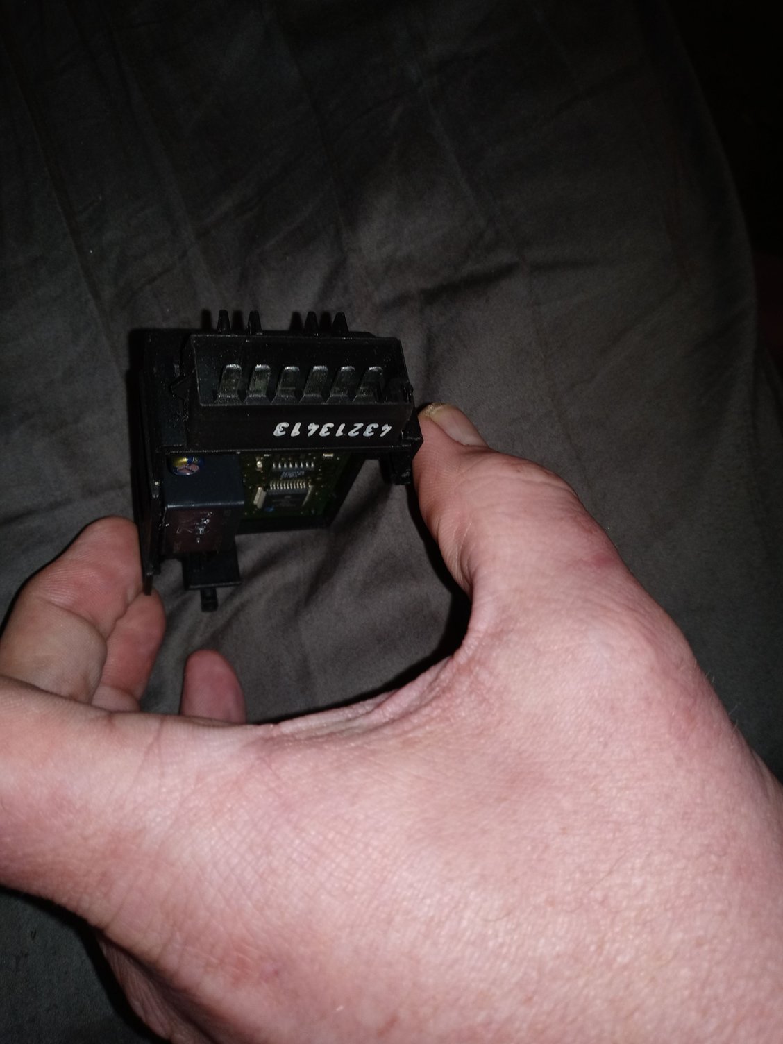

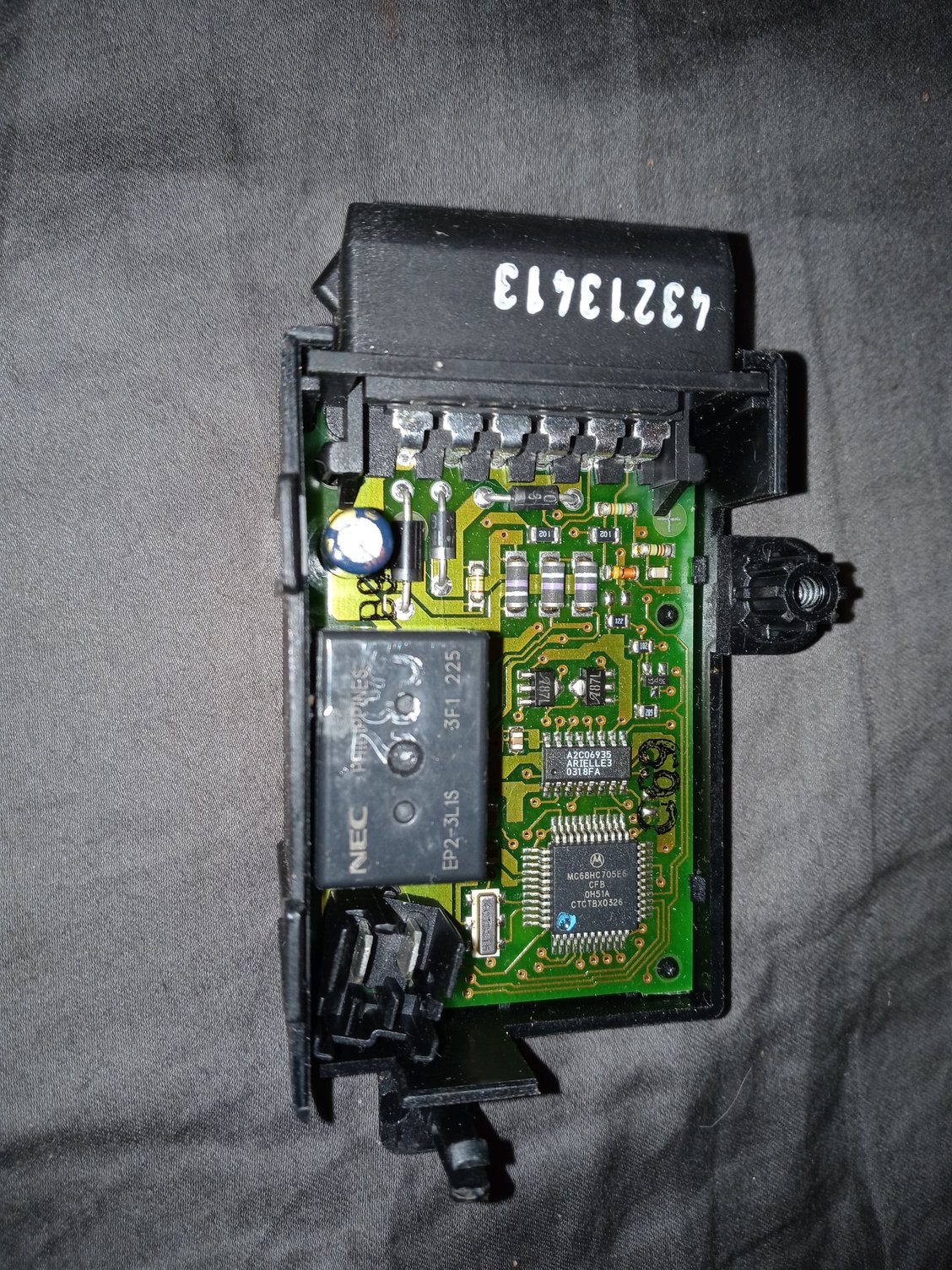

My sunroof will only open 25% of the way and it has the wind deflector that comes out and then it stops then I can close it and it will vent but I cannot get it to open more than 25% is there anything I can do to correct this problem? I did also notice an issue where my sunroof did not operate at all and I was able to fix that by putting two relays in and bypassing the circuit board connected to my motor. Does anyone have a circuit board laying around from their sunroof motor they're not using they may want to part with and can send one to me? I am including a picture of the part I'm talking about that was connected with my motor.
I'm wondering if there's something I can do to fix the alignment or whatever it may be that's stopping the sunroof from opening more than 25% though maybe something got misaligned please let me know any help would really be appreciated. Thank you

I am unable to do this because that board that is connected to the motor will not work when I have it connected I can't do anything. I can apply power directly to the motor and it does work however it will only go so far when I'm opening the sunroof with it. What I did temporarily until I can get that board replaced is used to relays so I can use it with reverse polarity on that same motor.
I'm looking for the board to replace it
