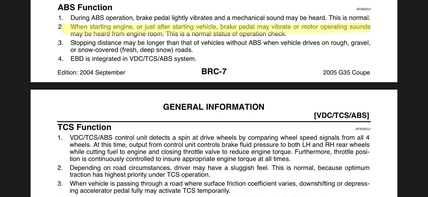

Its the car testing the ABS system. It does it the first time u hit 10mph after a start.

From the manual

Yep it's the motor on the ABS valve block, turns on for about 1/2 a second the first time you hit 10mph. It's one of those things that's hard to unsee once you are aware of it
