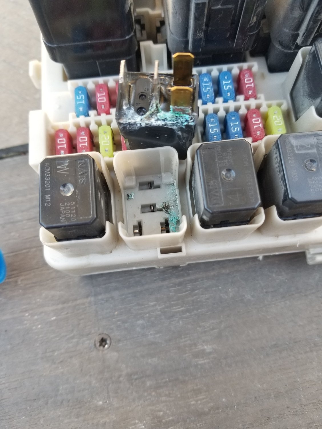

Hey thanks a lot for the help, a few of my relays had this corrosion, this ones the worst. I took the IPDM most of the way apart and I i'll just replace the whole thing, drying it out got rid of a check engine light though. I think i've found a good one on ebay to replace it with. It's marked as being for 2004-2006 coupes, should i go with a year specific one or will it be the same?

Before you order up a replacement IPDM you should try just cleaning out the one you have. That corroded relay you can use aerosol electrical contact cleaner MAKE SURE THE CAN SAYS SAFE FOR PLASTIC, spray all that crud off the IPDM contacts, get a new relay, apply a very light layer of electrical anti-oxidation grease to the pins on the relay and plug it in.
The IPDM is actually pretty robust and a minor amount of corrosion like that isn't the end of the world as long as there is metal left, they can be fully submerged, dried out, and keep on working. The contact cleaner will get the crud off, the anti-oxidation grease will keep it from getting worse. The biggest thing like Scorpio said is to fix the drain so it doesn't happen again.
