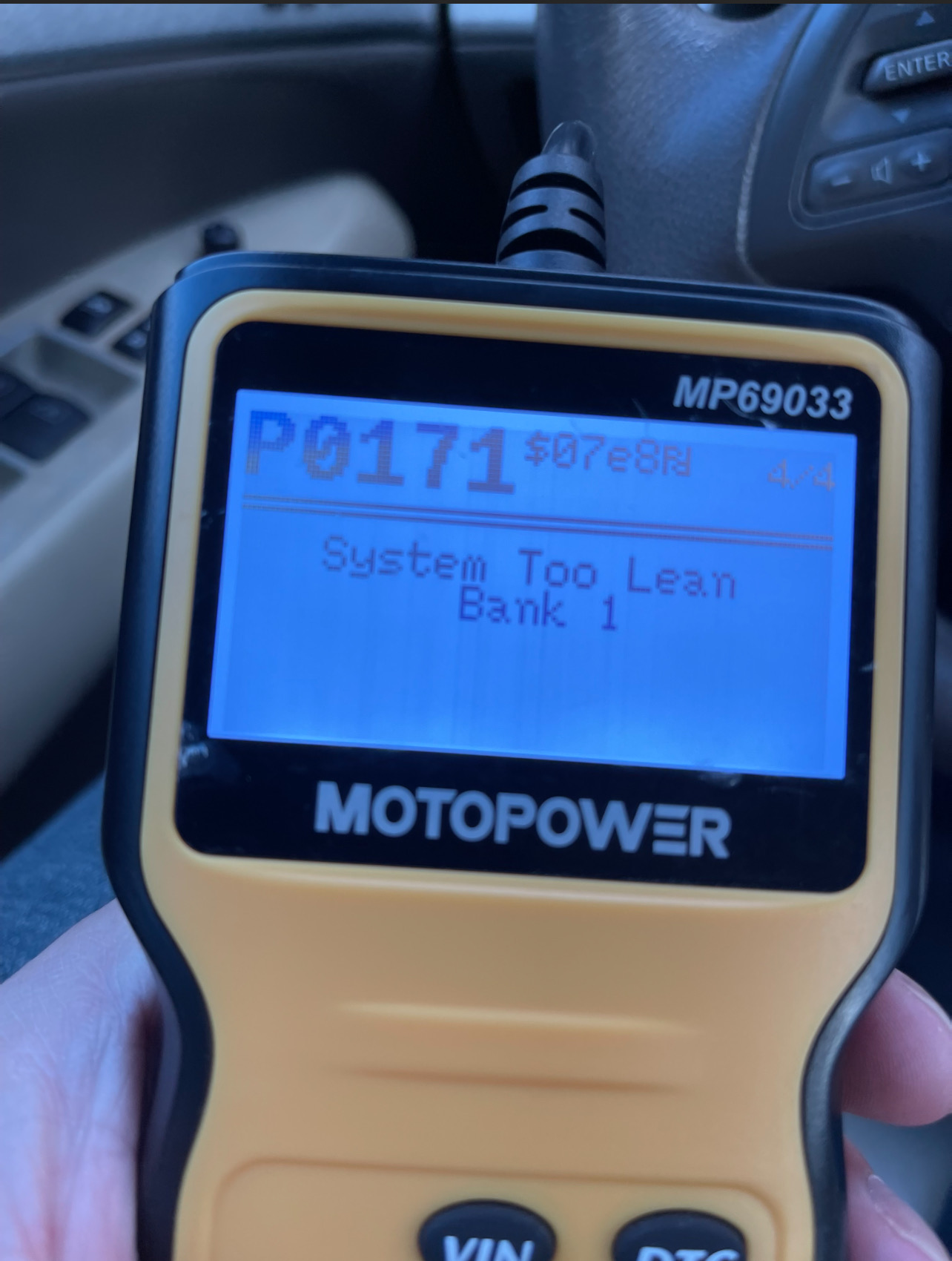

I use a cheap ODBII reader by MOTOPOWER, i bought off Amazon. I had multiple cylinder random misfire codes before new coils and spark plugs. Now just have 1 P0300 $07e8??
Had Firestone do a full diagnostic. They put a new spark plug and coil into cylinder 1. And received the same P0300 and P0171.
They said the next thing they would do, is to change the fuel injector. Quoted me a piece of around $1500. Just for 1 fuel injector. I don't have my own garage or way to get underneath the car.
Am I missing something?
P0171 is pointing to a lean condition on bank 1. View the short and long term fuel trims for both banks. Make sure you don't have any vacuum leaks, you may need to smoke test it to find them. Start with the easy stuff, vacuum hoses and intake ducts.
A compression test couldn't hurt either. It's entirely possible that a cylinder head warped from overheating the engine before. I wouldn't worry too much at this point, but regardless, you need to methodically diagnose this rather than throwing parts at it. Contemplating potential issues isn't going to tell you anything. Kinda sounds like that's what Firestone was doing.
