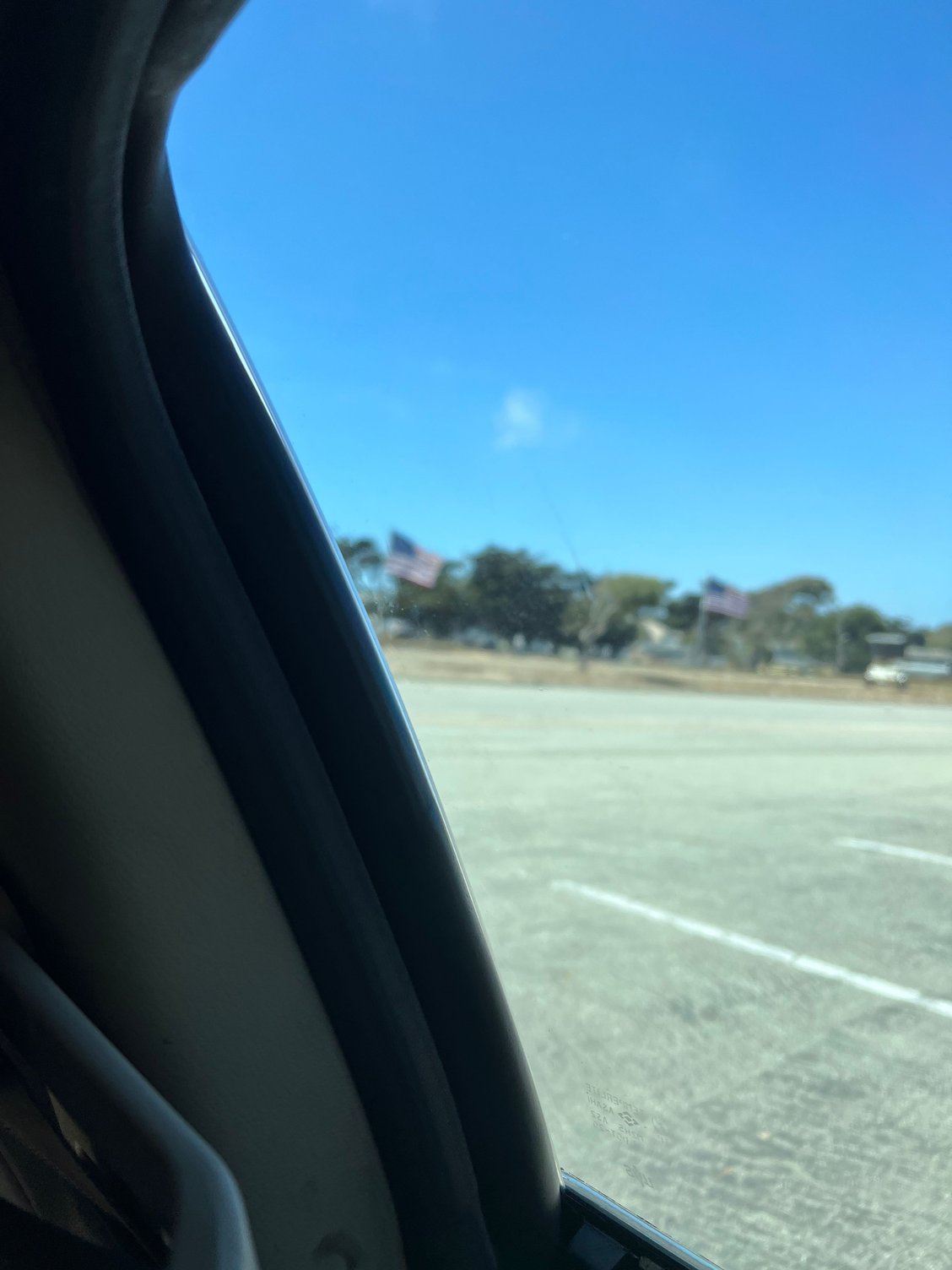

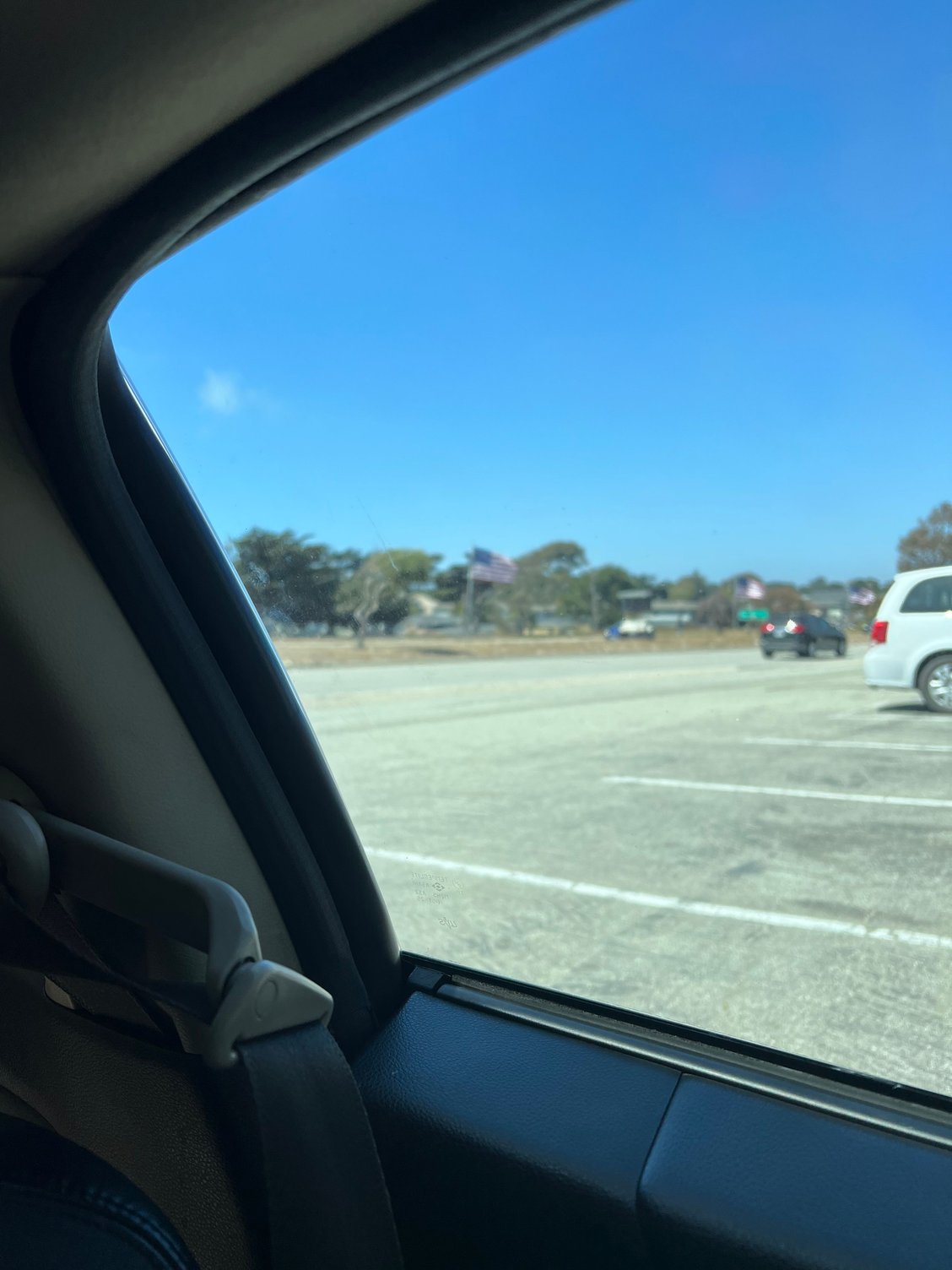

Anyone have this problem? Recently got the car from my older brother, and he says it’s always had this problem. Not sure if you can clearly see from the picture, but the DS window doesn’t completely close and has a small slice that’s open. It’s only annoying when I drive on the highway when the wind blows in crazy. Any ideas/fixes?

Window tilt needs to be adjusted.

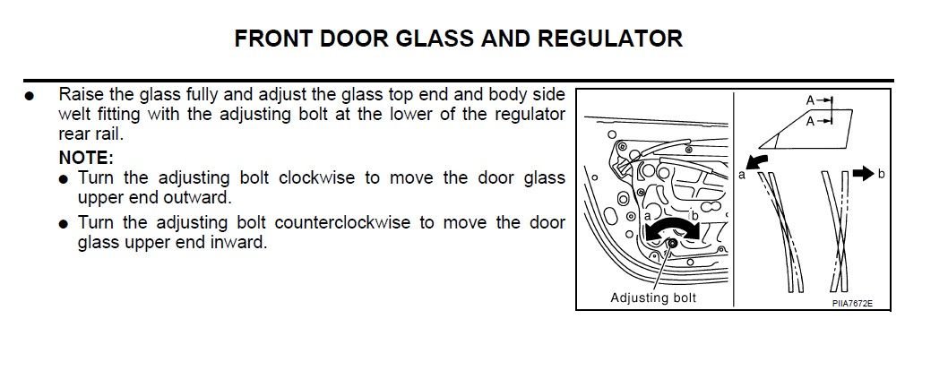

Yup, that's the thread.
Everytime you replace the window regulator or motor, you need to adjust or check that setting.
It's on my summer list for wife's car....for two years now..

Yup, that's the thread...but there's a diy thread or video out there.

Regulator yes it almost definitely needs to be adjusted. Motor, probably not but it something that should be checked every couple of years regardless.
I put a dollar bill in the door and adjust it until it's fairly tight pulling the dollar but not ripping it.
