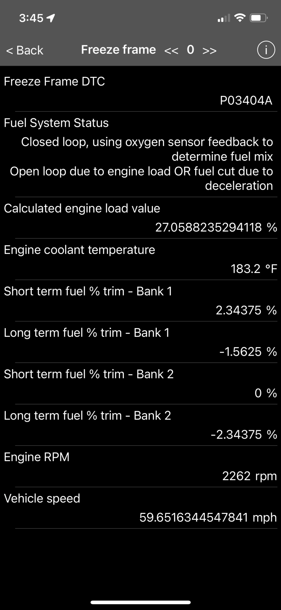

New info
I hooked the car up to a buddies scanner and got some info. In the picture the freeze frame detected p0340 as the source of why the car is going into limp mode and it kicked in at 2,200 RPM. Could I have gotten a bad ‘new’ oem sensor? Or do you think that it is still related to the p0011 code with the solenoid?

Hmmm....so if the error points to the cam or crank sensor, can you get in there and make sure you are getting voltage to those sensors by checking the wiring? I say this since you said you replaced them and with OEM so that shouldn't be the issue.
