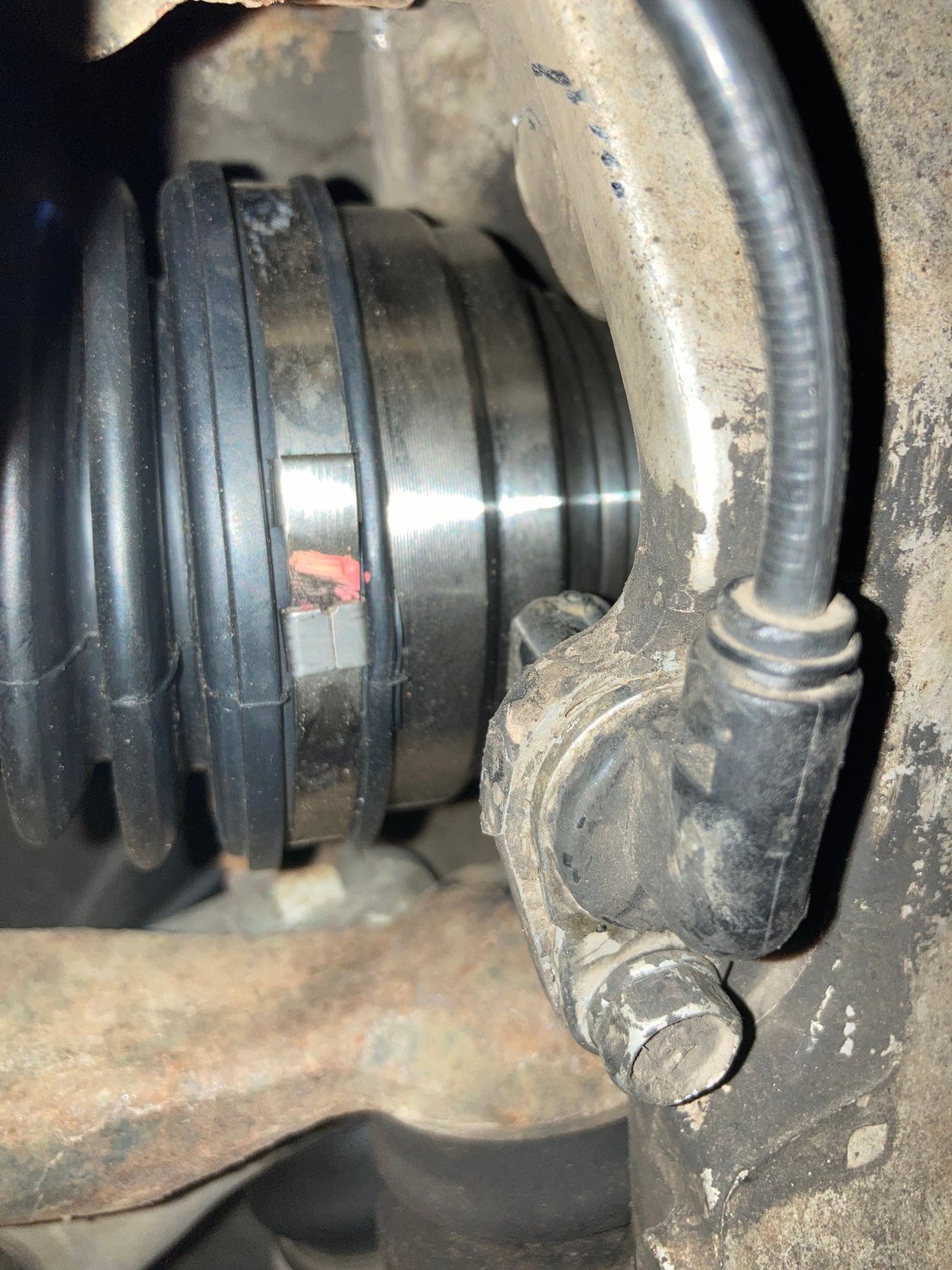

Thanks!!! I eventually pulled the VDC fuse, and that seemed to work as well. But I like your solution better. When I was double checking my installation of the right ABS sensor, I noticed that the CV axle doesn't seem to have a tone ring with teeth. There is just smooth metal under the sensor.
passenger cv axle
Is this my problem? I've heard of some CV axles having smooth ABS rings now, but I feel like this couldn't work the same as 46 raised teeth. Did my mechanic give me the wrong axle?

I would certainly think that would cause your problem that you are having. If it can’t read the speed of the wheel it will freak out. You mentioned you replaced the sensor, but the sensor in the pic looks original or like it’s been there for quite a while.

Yes, good eye! This pic is with the original sensor. I didn't want to confuse the issue with the entire story, but here goes. I was getting an 1108 (driver front ABS) code when I took the car in to have new tires mounted and balanced. Upper control arms had to be replaced because ball joints were shot. I asked the mechanic to just test the left front sensor while he had everything off. While changing the passenger side control arm, I guess they tore the boots on the cv axle, so they replaced that axle as well (but probably had to scramble for the part since they weren't planning on replacing it). Then they tested the sensors, and told me both left and right were bad. I was skeptical because I only saw a code for left when I brought it in, but when they returned it, it showed both sides. I figured it might have been damaged while testing, or whatever. No biggie. Here's the key, the car drove home fine because the computer had already disabled the ABS/traction control (3 lights) when I took it in (due to the left front sensor's inconsistency). I had already ordered a left front sensor (but not the right!), but saw another 05 g35x had just arrived at the pull your parts junkyard. So I grabbed one there just to test. I put that in along with the new one on the drivers side and then made what might have been an error. I cleared the ABS code with a scanner. Limp mode... etc ensued. Honestly, my right sensor wire looked in way better shape than the junkyard one, so I put mine back on when I realized the problem might be lack of a reluctor ring on the axle. Sorry, now this is way too long.
Main question, does anyone know of a reluctor ring out there that could work with my sensor that looks like that? My understanding is that these are simple magnetic devices that create an on/off current as each tooth goes by the sensor. It seems unlikely (but possible?) that the smooth ring shone above has 46 magnetic poles inside that would match a toothed ring's signal. My mechanic wants to charge 5 something to replace both sensors to fix the problem. I don't want to drop 200 (his price) on a new sensor if the axle is the problem.

I'm almost 100% sure that's the wrong axle. They always have a pickup ring on them nowadays.
Go down to an auto parts house like Autozone, Napa, etc and have them pull a front axle so you can see if it's got a ring on it.
If it does then take it back to your mechanic and tell them they used the wrong part.

Limp mode was definitely caused by the lack of tone ring on the axle. Mechanic agreed and replaced the axle. But my new left front abs sensor still appears to not work. I sure hope there isn't a fault in the wire between the abs relay and the sensor harness clip. That's one complicated (and hard to reach) set of wires in the harness running between the two. I guess I need to get an oscilloscope. I have a junkyard pulled left sensor and relay. I could try those first...
