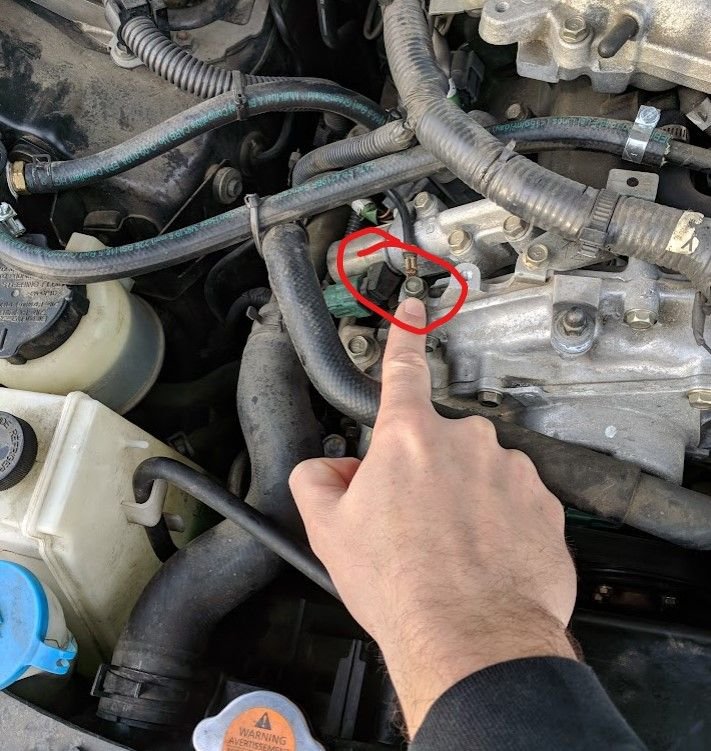

Big green colored bolt behind the instrument cluster near the ignition cylinder, glove box, sorry I said behind the HEAD UNIT earlier which is not correct and I keep forgetting on the G ECM ground is behind the GLOVE BOX.
Here's the one behind the instrument cluster. Since it's a multi-term crimp I would get in there and inspect this one pretty thoroughly to make sure all the wires are snug, a little tug test is probably sufficient. This is my primary suspect, it is the ground for your dash.
Next, the ECM ground MIGHT be the culprit though, it's a lot more accessible than the one behind the instrument cluster so this is TYPICALLY the one that causes issues for people because of not tightening it properly after adding other ground wires to it for various other cabin electronics.
Here are two pictures of it.
Next, and I'll bring it up again even though I think you already checked it, the engine bonding jumper IS the alternator ground wire. It lands on the timing chain cover on the right side of the engine, then lands on the chassis on a 2-hole lug directly below the coolant reservoir.

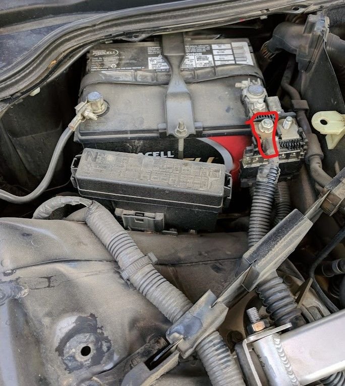

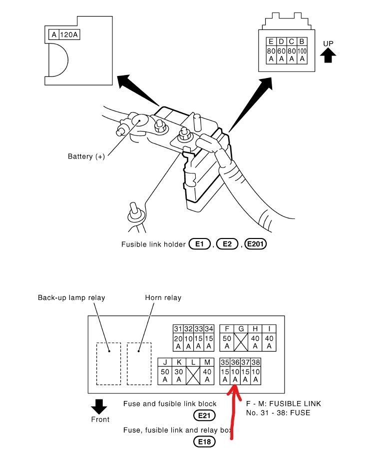

You should also check the positive side of the alternator circuit which fortunately is much simpler.
First check the primary where it attaches onto the fusible link, I strongly recommend completely disconnecting the fusible link so you can really get a good look at this thing especially INSIDE where the fuse goes to make sure it's pins aren't corroded. Primary charging is on the big wire I circled in red, the feedback loop BACK TO the alternator voltage regulator is fuse 36. If there is corrosion on the fuse or damage to the fusible link the alternator might be reading actual voltage incorrectly and wrongly cycling the regulator. However you would usually see something wrong with a digital multimeter, still something you should inspect though...
Keep in mind that the dash light will turn on from both under voltage (more common) as well as OVER VOLTAGE which can occur if there is resistance and corrosion on that feedback loop back to the regulator, or if the circuit is just stuck open due to a blown fuse or something. You can accidentally charge a battery up to about 18vdc (the extreme upper end of what an alternator can usually make) which makes them VERY hot, most of the electronics will survive at 18vdc though, your fuel pump will be hating life and delivering too much pressure and flow at that voltage though. I imagine the instrument cluster on the G35 is designed to turn on the light at lower than 11.5v or higher than 15.5 volts. Never tested it but that's usually where lights turn on with other vehicles.
Next is the monitoring circuit for the instrument cluster, cabin Fuse Block - J/B fuse 14 (10amp) supplies power to the instrument cluster voltage monitoring circuit, ground goes directly back to the alternator (through a super multiple junction).
I doubt the fuse is the issue and I think the light would not turn on AT ALL if the fuse was blown.
