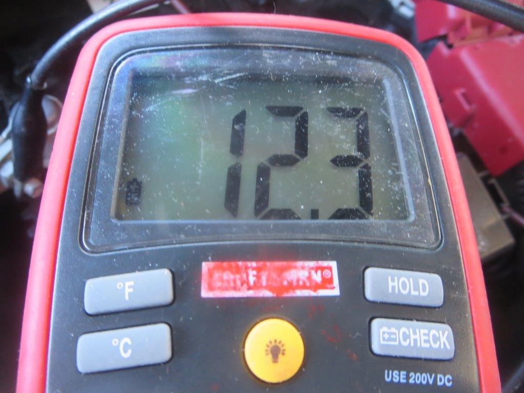

What voltage are you getting at idle, and 2k RPM?
Idle 12.3 to 12.6
2k RPM
Telcoman
