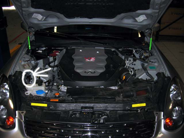

For anyone interested, I mentioned it to the mechanic, and after checking the battery and connections themselves, they saw that the alternator was charging fine, then they looked at this box (not a pic of my car):
Not sure what it is since I'm not really car-inclined, or if it's even related but they unplugged it and rusty water seemed to come out of it. They replaced it and after driving about 200km, the lights haven't re-appeared yet.

Originally Posted by divito
Yes. After lurking through the forums, I popped the hood and started checking connections and such. Everything from my limited knowledge seemed fine.

Originally Posted by coffeysm
Isn't that the hood sensor?
If that includes a plastic box with two connectors running from it, then I guess so. If you're referring to the rubber-covered **** that depresses when the hood is closed, then no, but they're right next to each other.

drkay's Avatar
Joined: Sep 2009
Posts: 244
From: Calgary, AB, Canada
That is the DRL module. If you unplug it you will have no DRLs and no driver's fog light/high beams with the low beams on at night. (I dunno it's weird.) If unplugging that fixes the issue you likely have a loose ground coming out of the passenger side loom.
