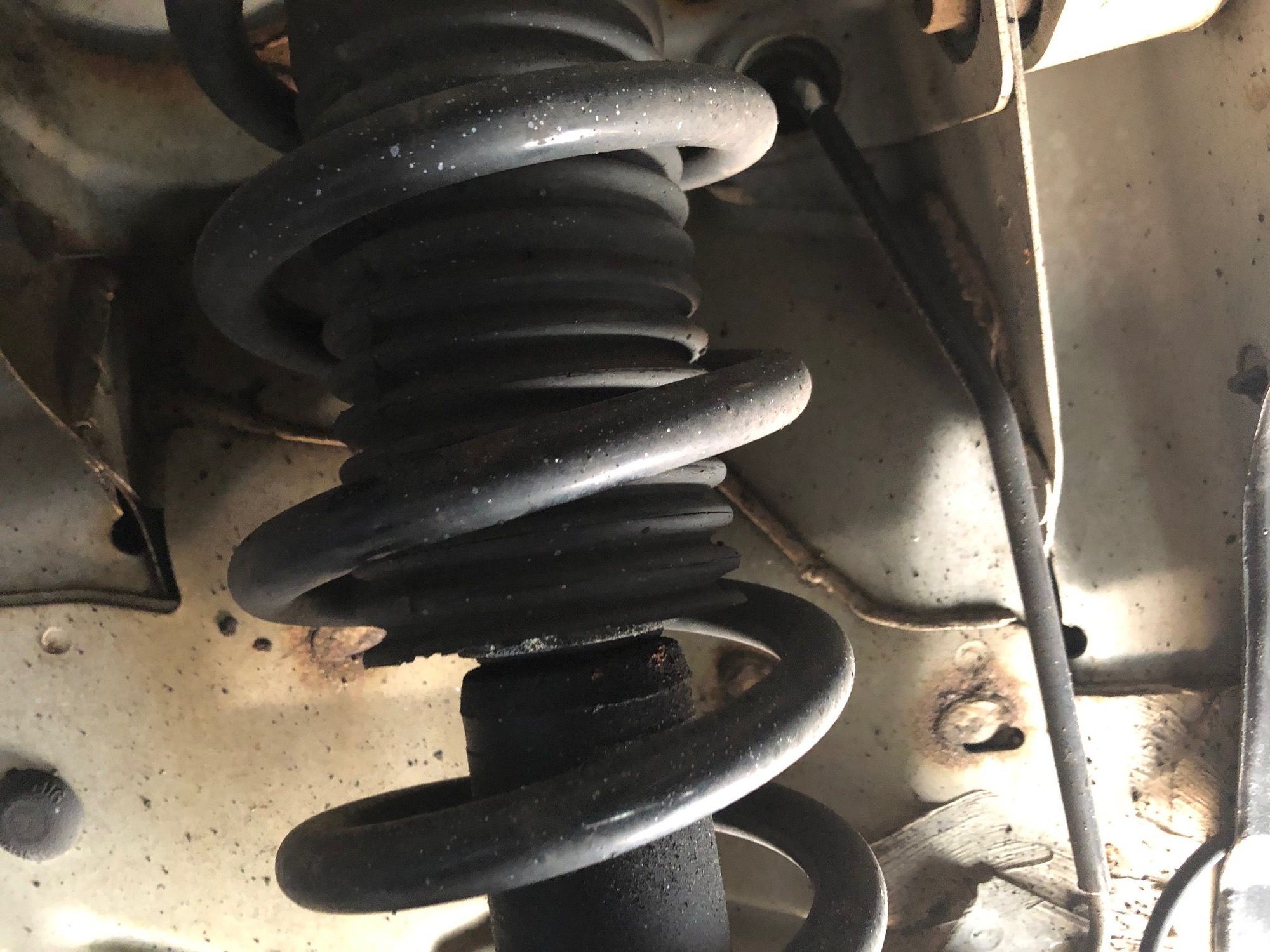

I noticed recently over the last few weeks that when I do a right turn occasionally, I hear squeaking from the suspension. So the first thing I did was verify that the tires were all at equal pressure and after doing that, the suspension squeak has reduced. However, I still hear it on sharper right turns.
I looked and took a photograph of the car's shocks on the passenger side and would like to understand what I need to change. I have never done suspension work before and would like to do this work myself, so any tips and advice and links that can be helpful will be very much appreciated.
My car is a 2005 G35 Coupe 6MT with stock 19" wheels. Happy to share more photos.Please advise.
I am unsure what is squeaking, how do I figure that out ?
G35 Coupe Suspension on passenger side

cleric670, if you look at the picture I posted above do you think the rubber boot that looks worn out is the culprit or does it not matter at all ? I will try to buy some silicone lubricant spray. Which brand is the right one to try out ?

That dust boot just protects the piston of the strut. If the noise was only when the suspension traveled up/down then it's usually from a torn boot or just worn strut. But you said the noise is when you turn left/right.
The top of the strut rotates on a bearing. You should also shoot some silicone spray up at it as part of your troubleshooting.
I suspect you're going to find it's something like a compression rod bushing, those are notorious for failure and you can usually just SEE how badly degraded they are with a visual inspection.

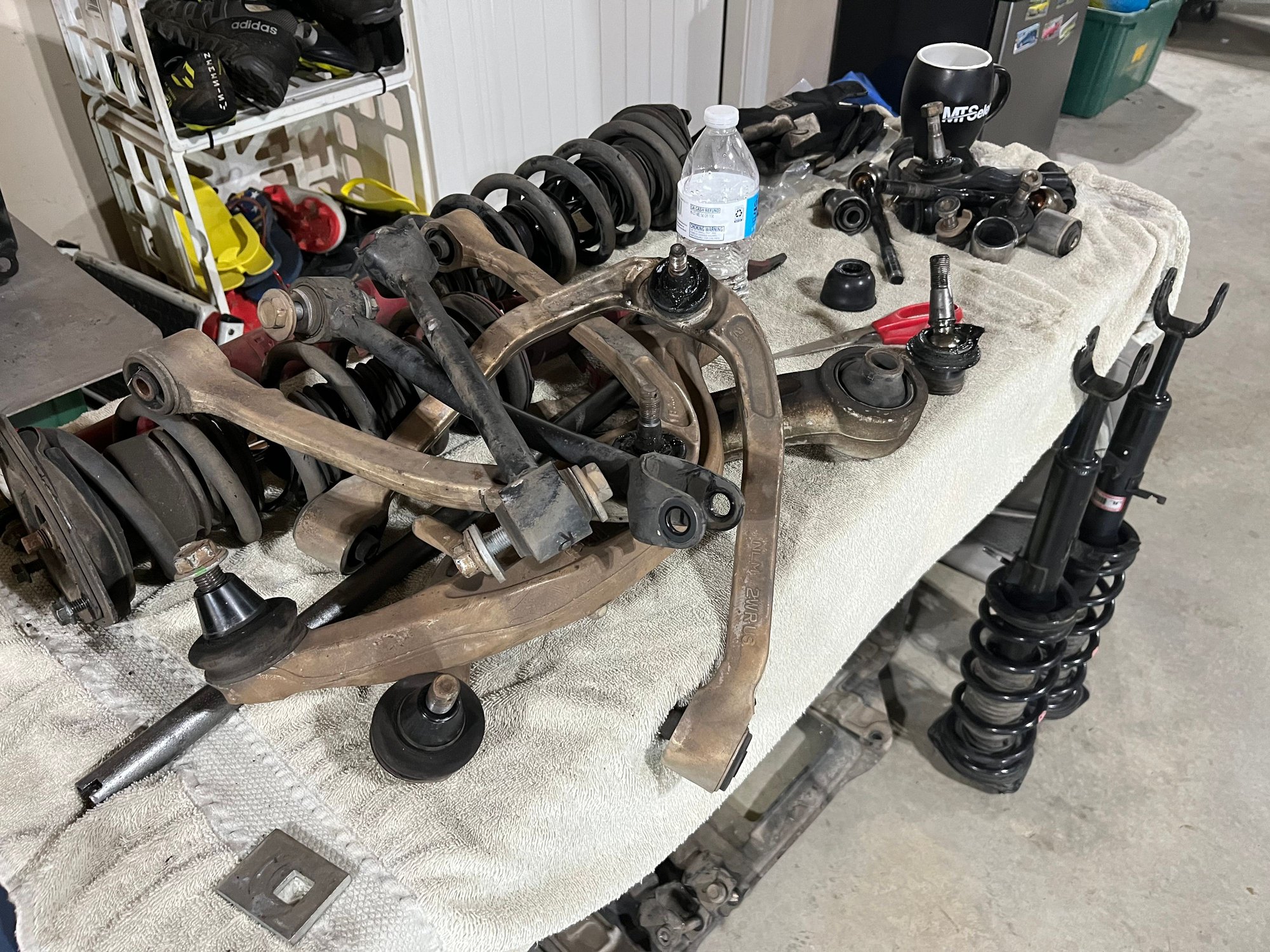

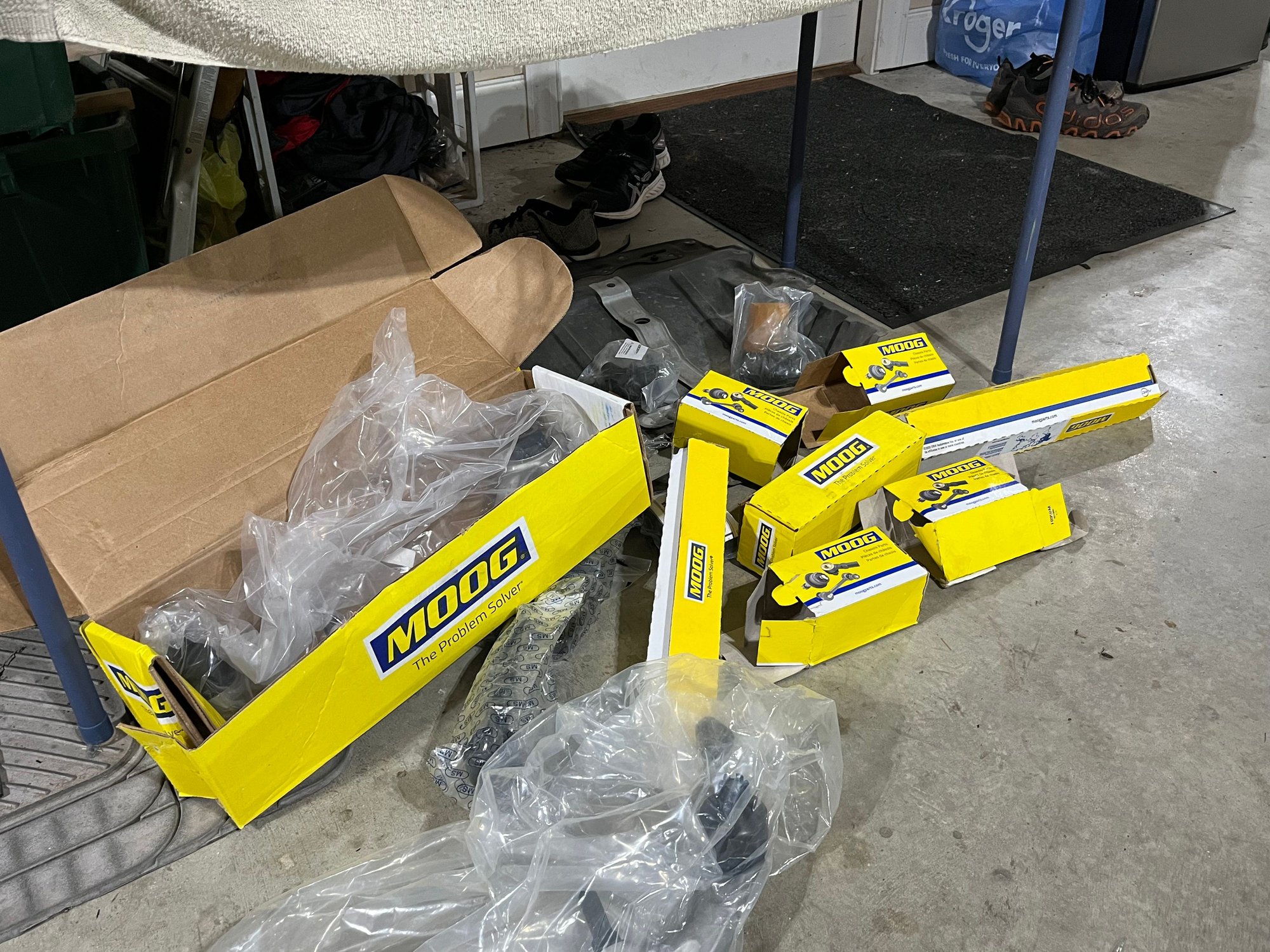

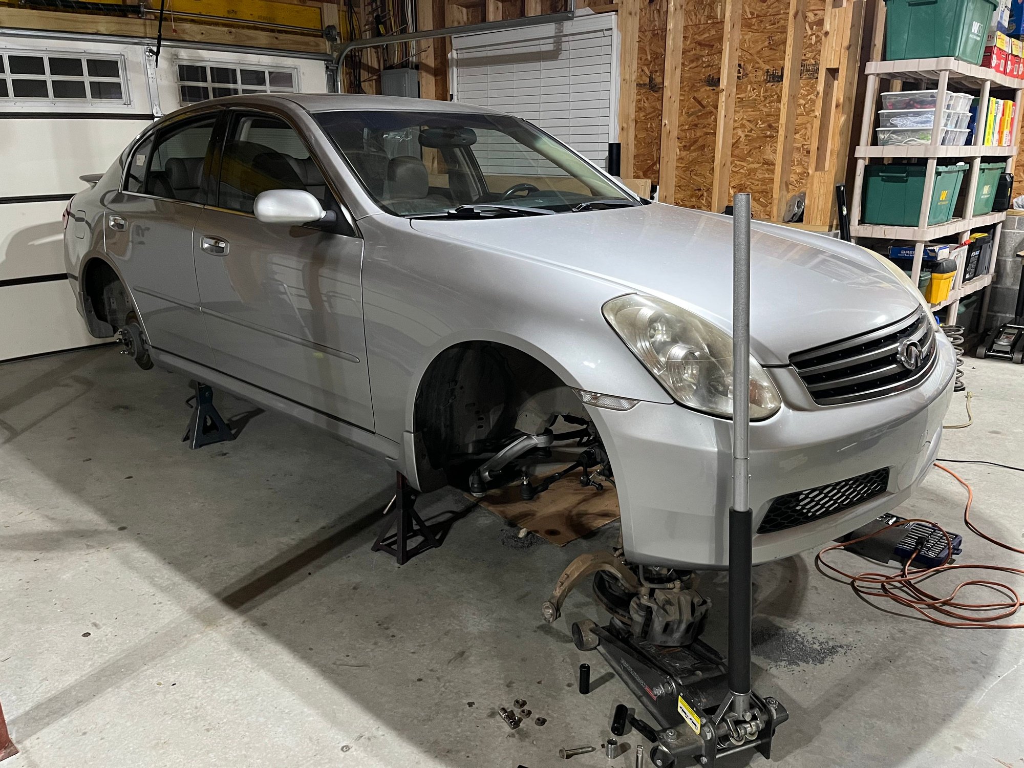

When I bought my sons car last summer, we had similar issues. All sorts of knocks and squeaks from the front end. Last month, I ordered compression rods, lower control arm bushings, control arms, tire rods ball joints from RockAuto and all-in, it was extremely affordable. The car rides like a dream now. Well worth the money and peace of mind.

Nice photos Mr 6MTVQ
