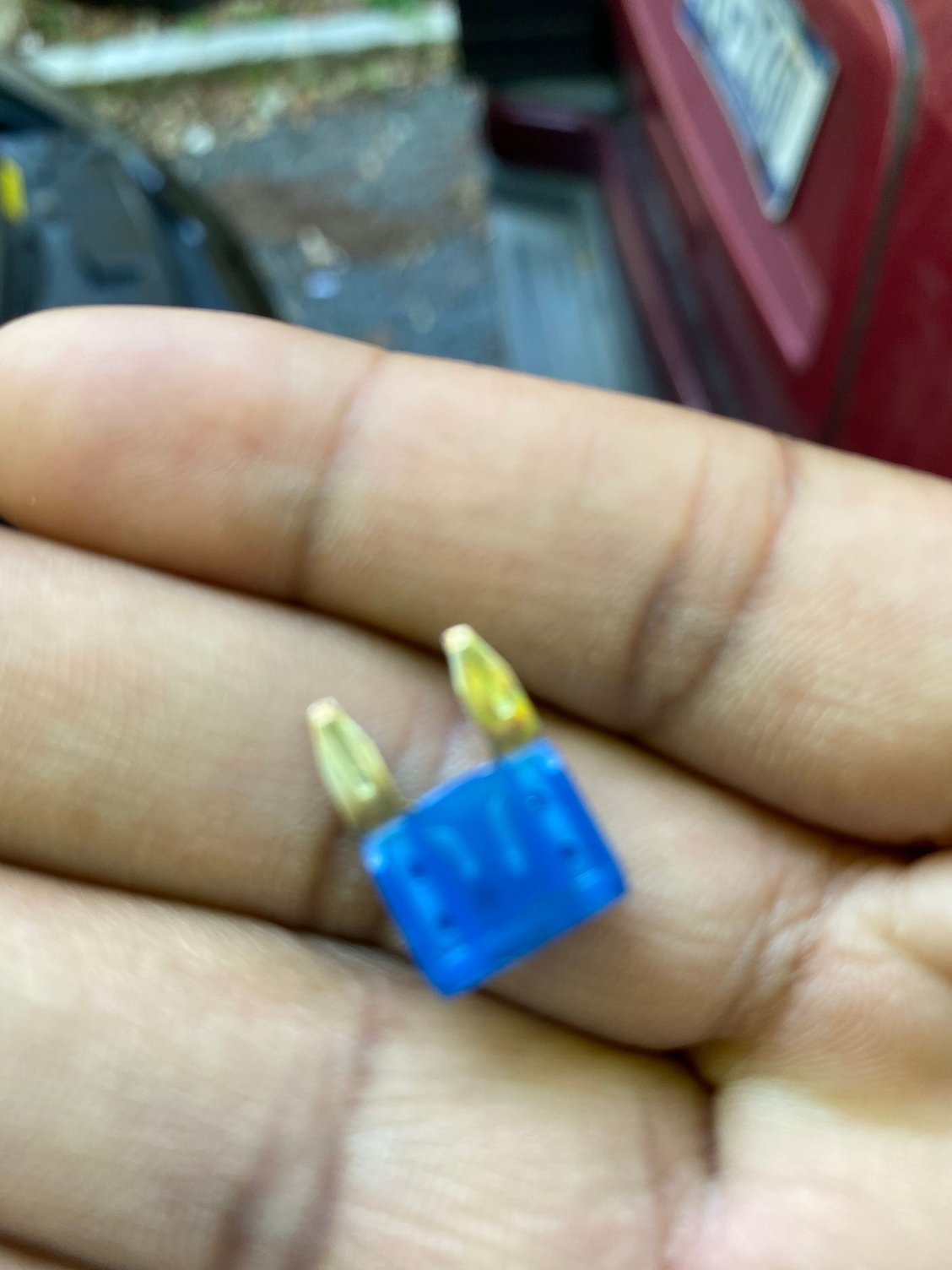

Thank you so much!!!
Also, post exactly which codes it's throwing. If you have codes for all four sensors it's probably a blown fuse 85 in the IPDM since they all use that for a power source.
It was a blown fuse!!!

Thank you you are a life saver!
thank you it save me the trouble of blowing 2 grand at the auto mechanic shop.
