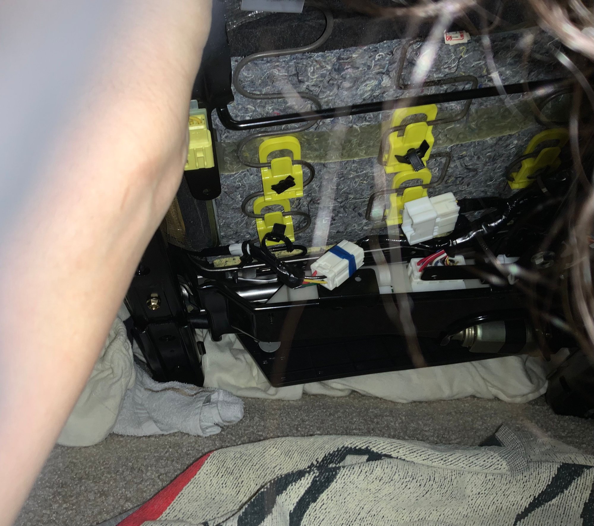

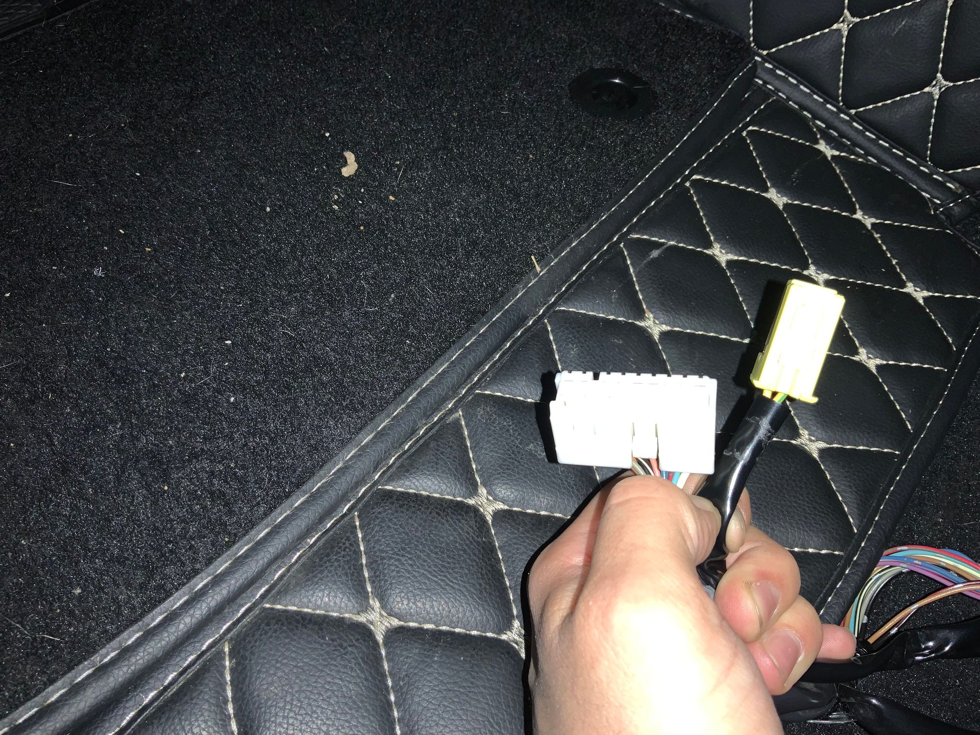

Old Jan 1, 2023 | 06:35 PM
Mg35gt's Avatar
Joined: Dec 2022
Posts: 68
Likes: 12
2006 G35 6MT Premium w/ leather seats
Which ones are they? So here is the only wires under my seat besides the one for the seat belt which is still functioning.
And here are the ones under the seat
Old Jan 1, 2023 | 11:08 PM
Urbanengineer's Avatar
Joined: Jun 2013
Posts: 11,174
Likes: 1,045
From: OH-IO
His diagram specifically shows Green, Yellow with seed, and Orange. Look for a 3 wire plug that isn’t plugged in down there, and that is where your resistor goes.
