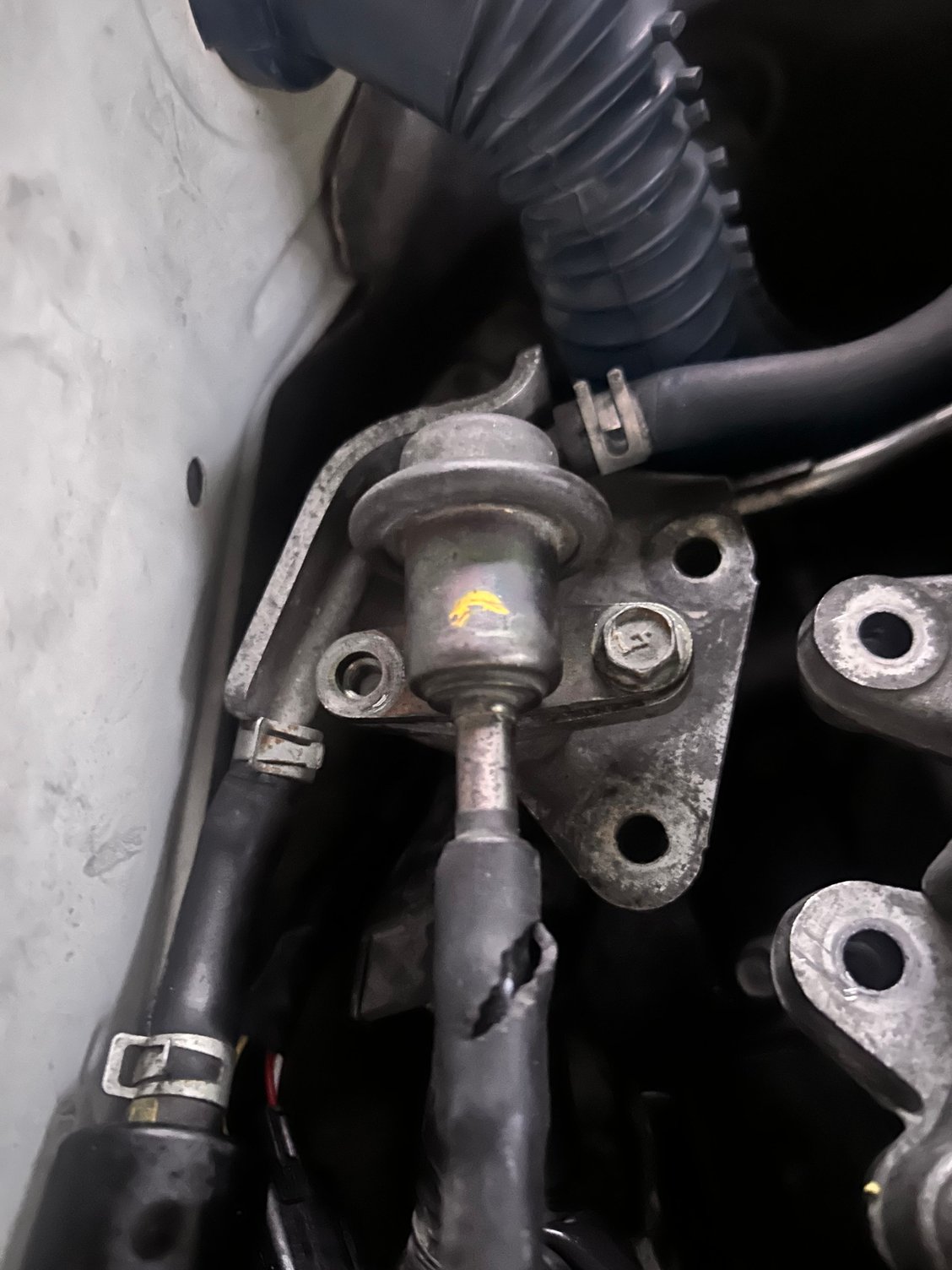

Jul 20, 2023 | 09:52 PM
Quote: what fuel bezel? & no it wasnt recking like fuel tho
that thing? Take the 2 10mm off and gently pull off cover your face and everything but see if fuel come out aggressively if it doesnt you have a pressure issue. Be very detailed about how the fuel came out when you reply, also you mentioned the spark plugs arent wet, that totally heads into fuel pressure.

I did take it off! & it does have fuel!

did it feel pressurized if so how much? if anything the injectors are probably not firing, crank the vehicle real quick and pull a plug to see if its wet again

Jul 22, 2023 | 12:11 PM
Z1 Motorsports sells a sandwich adapter you can put under that fuel damper which allows you to hook up a fuel pressure gauge.
