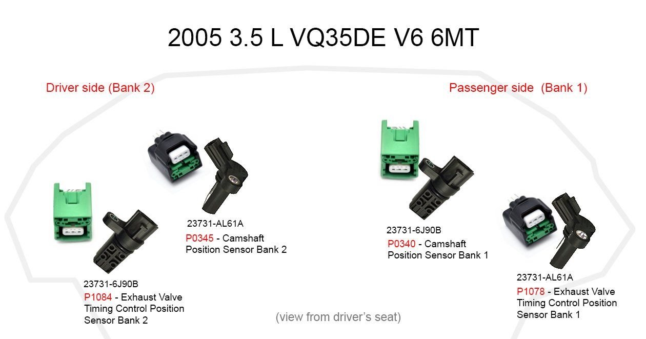

The knock sensor low input is usually caused by the sub harness getting brittle cracking, don't worry about this fix for now but rather focus on that cam sensor first. The knock sensor sub harness CAN be replaced without taking the intake plenum off but it requires equal parts luck and finger-jujitsu, there's some youtube videos you can look up if you want to try it. Personally I just take the intake manifold off...
Cam sensor code is for the one on the right side with the straight harness, only use a Hitachi sensor (OEM manufacturer). Ignore the rev-up exhaust sensors in this picture, you have a non-rev DE engine.

Thanks Guys, I replaced the Camshaft Sensor with a Hitachi Brand Sensor and now I'm back up and running. Driving it a few days now and no more check lights and it have not turned off.

Quote: The knock sensor low input is usually caused by the sub harness getting brittle cracking, don't worry about this fix for now but rather focus on that cam sensor first. The knock sensor sub harness CAN be replaced without taking the intake plenum off but it requires equal parts luck and finger-jujitsu, there's some youtube videos you can look up if you want to try it. Personally I just take the intake manifold off...
Thanks @Cleric670 for all the Good Detailed info as usual. Really Appreciate it.
