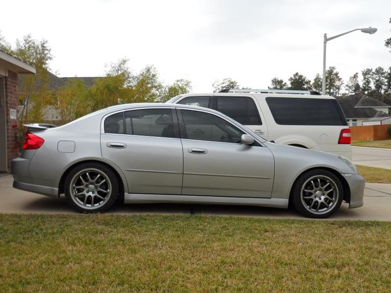

I just put H&R's on my X it's perfect for a daily driver. I read through a lot of this thread first and that was my choice rather than get into coil overs. I come from modding high horsepower Mustangs and Cobras and alot of guys on SVTPerformance have been running H&R springs on those cars too with a perfect stance. I love the srpings and I can't imagine going any lower for a daily driver but it took the 4X4 look off the car and it rides very nice sporty but not bouncy.
I also put on SPC front A arms, and SPC rear camber arms and toe bolts to get the alignment right so I don't go through tires. I bought them from TH Motorsports a vendor on here for the best price $525 total and put it all on in my driveway super easy just takes some time. I took my front struts to a shop and had them put the new springs front springs on front Monroe replacement struts whiel I was at it since I'm at 80K miles. I would have done it my self if I wan't lazy and had air tools to compress the spring but to me it was monery well spent.
I'll get some pics up soon just need to wash it first. I just paid $281 for my new springs shipped from an ebay seller in Dallas.

I would love to see the pics, im for sure going to put springs on my x just cant decide which ones yet.
