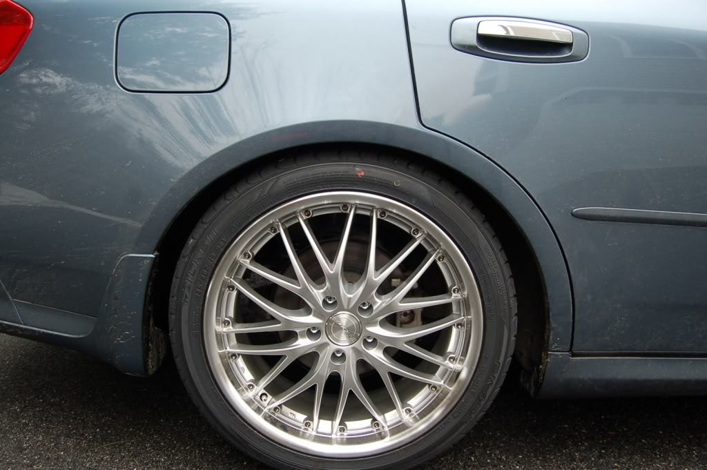

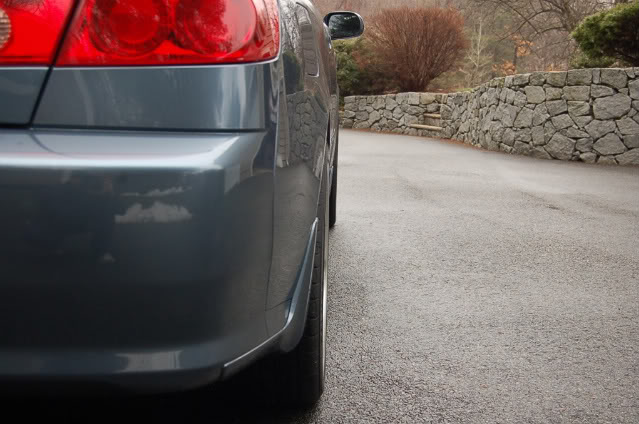

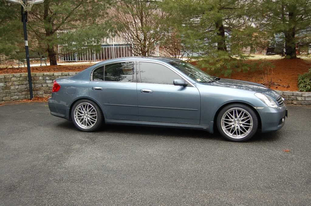

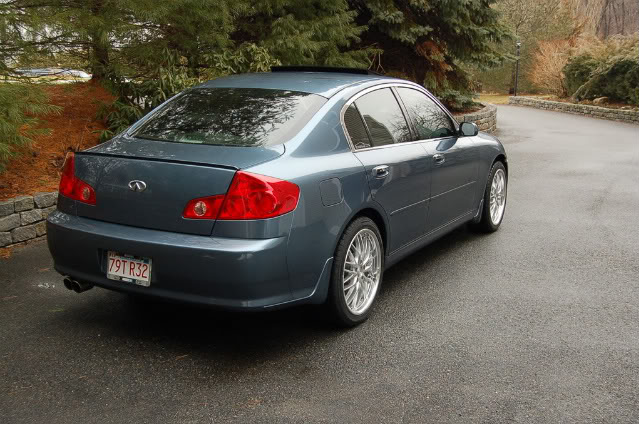

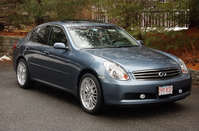

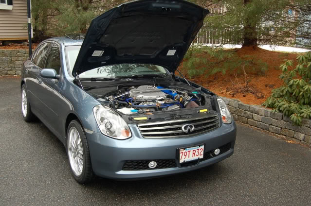

Next Saturday cannot get here fast enough
H&R springs go on next weekend, but I had to throw the new wheels on for a week so I can judge the difference in ride before and after the springs. These are 19in MRR GT-1 wheels with Falken FK452 245/40/19 tires. The ride feels great so far. Old tires had a bit under 28k on them, so these feel much softer. Even with a bigger rim.

Nice wheels, complements the color of the car, the drop will tie it all together.
Love the fogs by the way. Post the pics when the springs go on!
+1 to H & Rs ride over Teins.

JMAN, would the 40 series tire cause any rubbing problems when you drop with H&R springs? as you know, i'm most likely going with the same setup lol
Old Mar 12, 2008 | 04:31 PM
  #639
JMAN44544's Avatar
Joined: Aug 2006
Posts: 198
From: Near Boston, MA
I have 245/40/19's and I have 3 inches, pre drop of clearance with a +35 offset. I do not think the 18's with the same other specs should cause an issue. I am getting the work done Saturday am. Will have pics up that afternoon.
Think you will be fine.

Great idea to mount the tires first to see the difference in ride characteristics. I highly recommend you test out your cornering abilities now, with the 19's on & stock suspension....then give it a shot next week...you'll see a world of a difference. Also, I think your car will look 10X better on those rims once you drop it...good luck w/ the install!

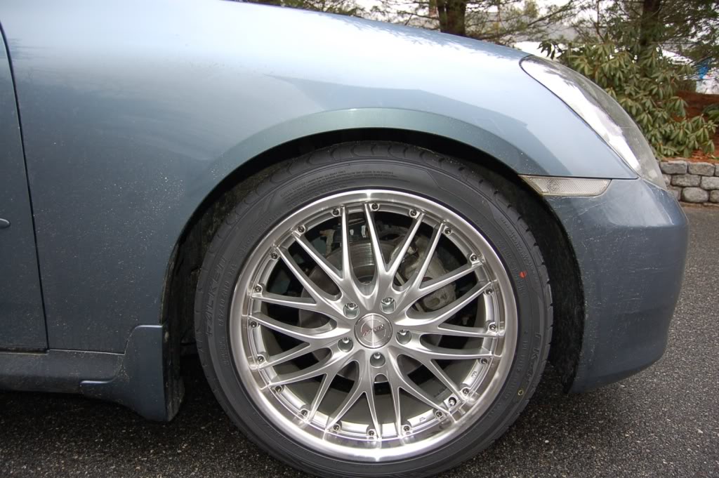

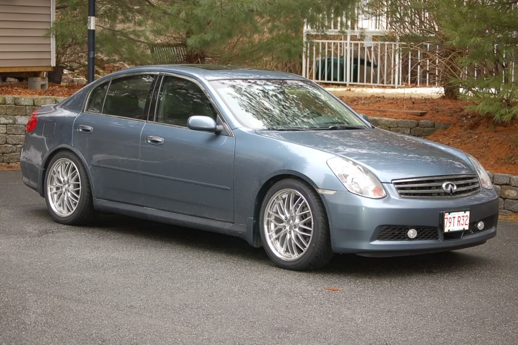

The Shocker
Two fingers in the front and one finger in the back...
Ok, it is a bit better than that. Pretty much a 2 in the front and 1.5 in the back, but not exactly the same.
So I threw on the H & R sedan springs, SPC rear camber kit and bolt kit today. I left on the stock shocks. I drove home from the shop ('bout 45 mins on the highway) on the stock rims and tires and the drop felt amazing. Not bouncy at all. Very tight, less boaty. Some had commented about the ride being bouncy in the rear with some of the drops they had, it is day one, but I do not feel it a bit. These springs are progressive, vs the TEIN that are linear springs, so may be some of the difference.
-Thanks again to qbturbo, Seddon and Flying Lumpia for your help with this.
I have not driven the car yet all finished. Sad but true. Will do that tomorrow and see how she feels. But as far as looks, she looks pretty damn dirty and nice to me at the same time. Will post some cleaner pics at some point, but aside from water, soap and wax, I am done with the outside of this car.
Maybe Turbonetics next spring when my warranty wears off and I have nothing to lose...
