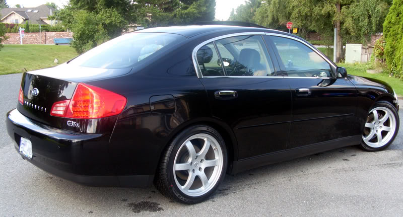

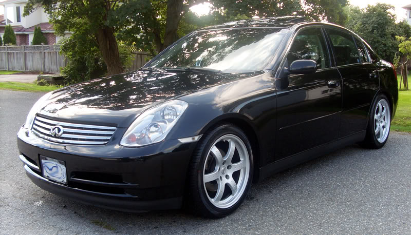

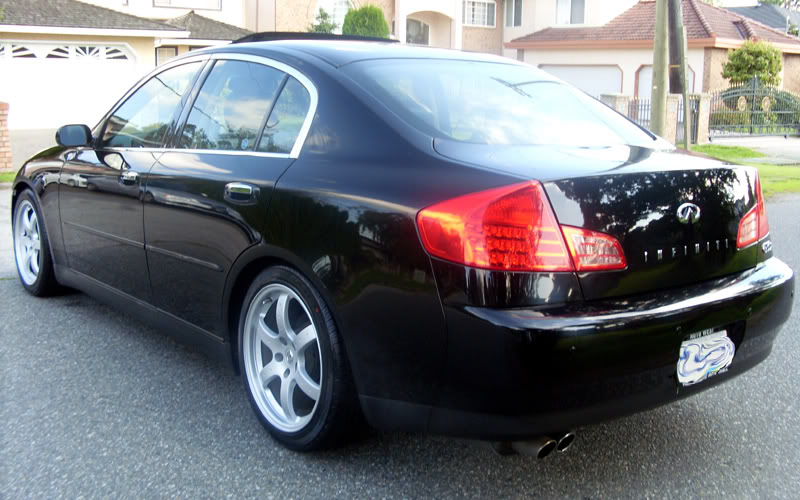

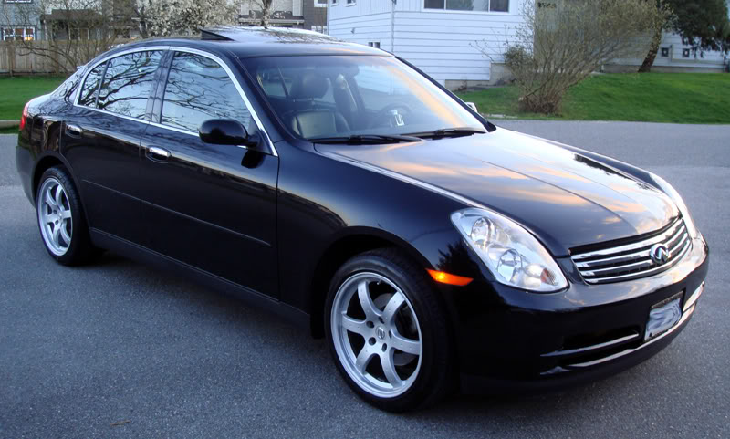

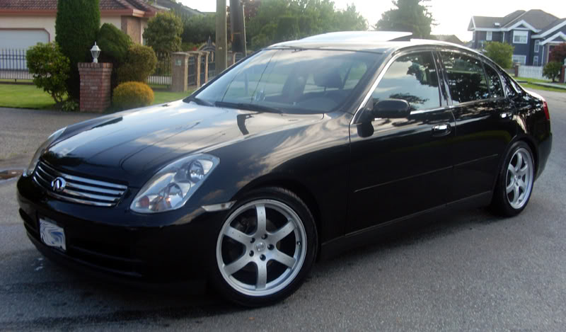

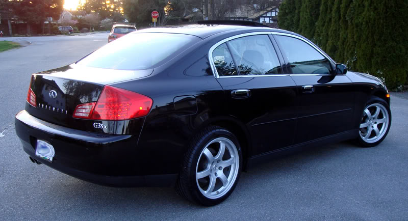

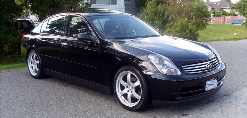

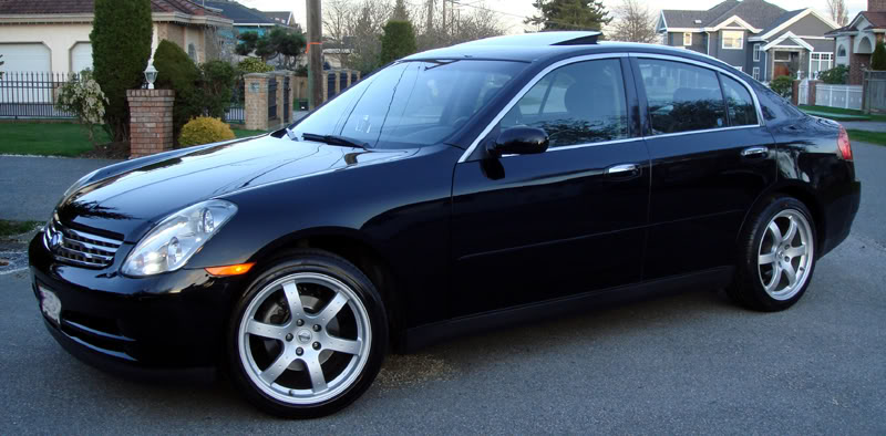

Finally got the X lowered on Coupe Tein H-tech!
Before
After
Old Sep 4, 2008 | 05:27 PM
  #864
RicoG35x's Avatar
Joined: Nov 2007
Posts: 483
Likes: 24
Bro, this looks very sweet.. I also have an 04x... any issues so far... how about alignment.. the usual camber off stuff everyone reports after dropping their rides..?
How is the ride.. firm.. mushy.. any bottoming out or rubbing..?
curious minds need to know..?
I've been looking for SOMETHING that would work on the x... nobody wants to play with us... no awd toys in the suspension dept.!!
dude.. I LOVE the 04.. classic lines...!!
Old Sep 4, 2008 | 06:21 PM
  #865
jal723's Avatar
Joined: May 2008
Posts: 26
From: Richmond, BC
Thanks for your kind words!
I don't have any problems so far.
I had an alignment done right after the springs' installation.
As for the ride comfort, it's similar to the stock!
I did, however, scraped the underbody when I went over a high and long speed bump
Anyone know where to get a reinforce under body skid plate?
