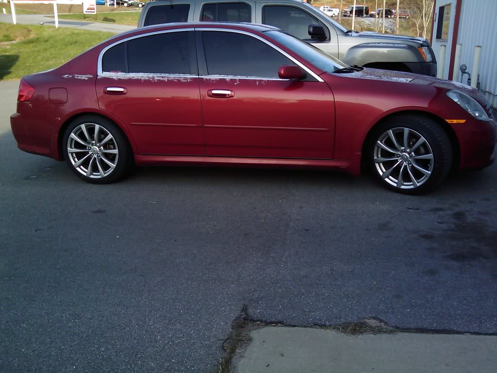

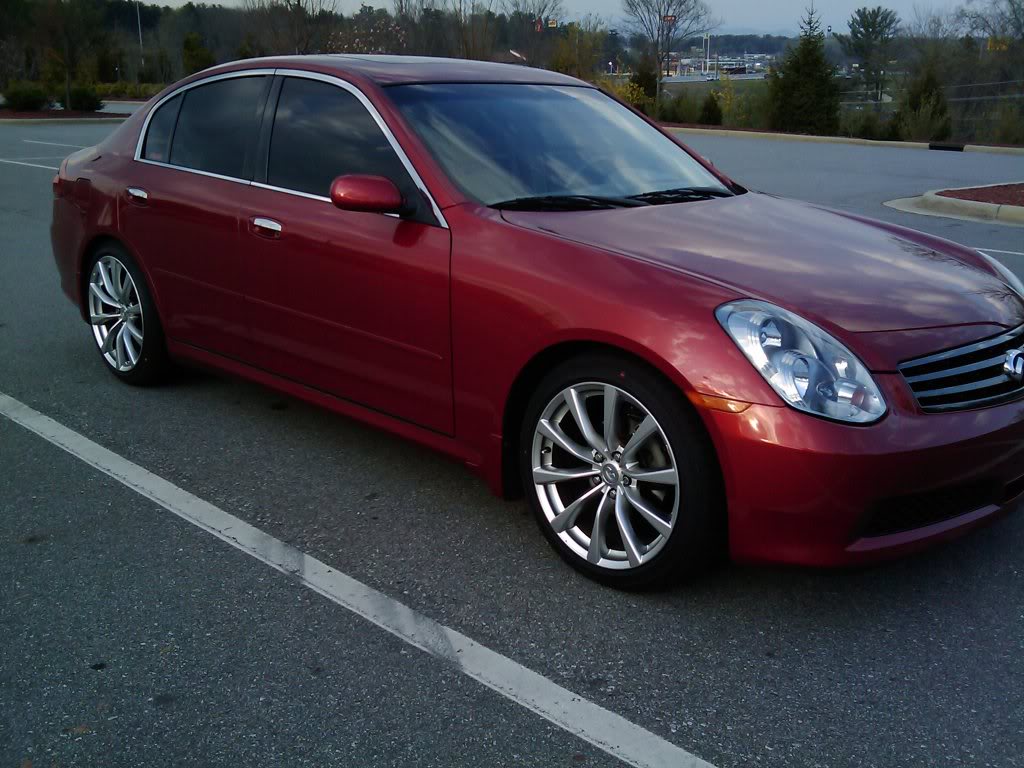

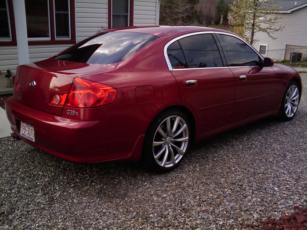

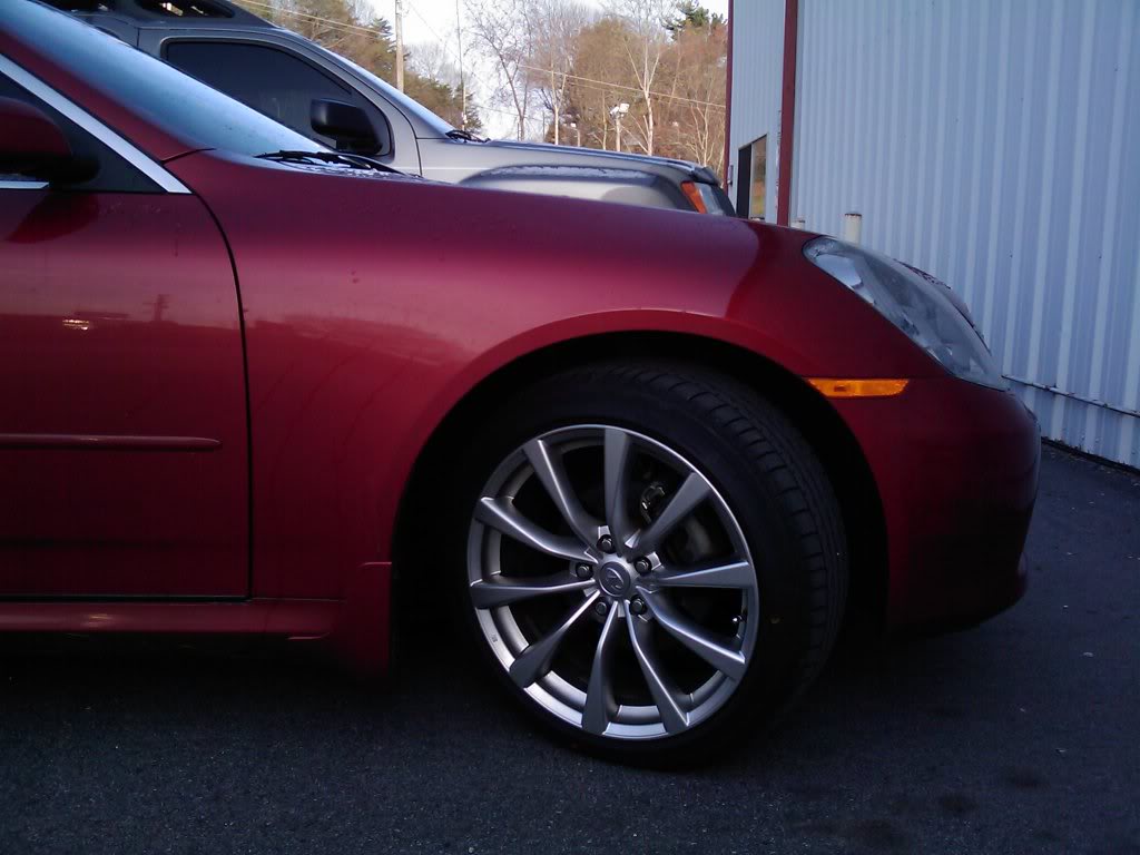

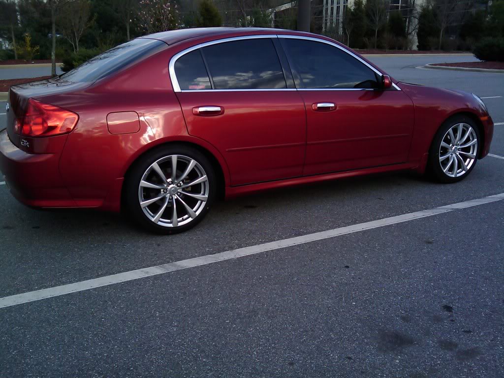

New Pics 4/8/09
Hey everybody! Finally got time to have my 350z fronts installed today. Looks and rides great combined with the revised coupes in the rear. Fender gap is equal now front - rear, making it all look perfectly level...although the car actually has a slight forward rake now (which I like). Very subtle.
Before: (still with some snow on her)
After! : )
I also debadged "Infiniti" off the rear trunk. Looks more sleek and streamlined.
The pics don't quite show the difference you see in real life, but they're close enough. This is a great combination of springs for lowered height while maintaining ground clearance and ride quality. The front feels slightly stiffer now, but I notice less body roll and less brake dive.
