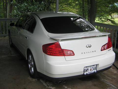

G'd Out's Avatar
Joined: Jun 2007
Posts: 124
From: Florida
I removed my Infiniti and G35 on mine. I heated half of it and used floss on it. The other half I just my fingers. Between the both, the heating did nothing extra. The floss will cut it slightly closer to the body, but not much. Then I used Goo Gone and used my fingers to take care of the rest.
