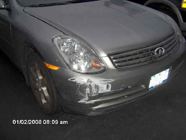

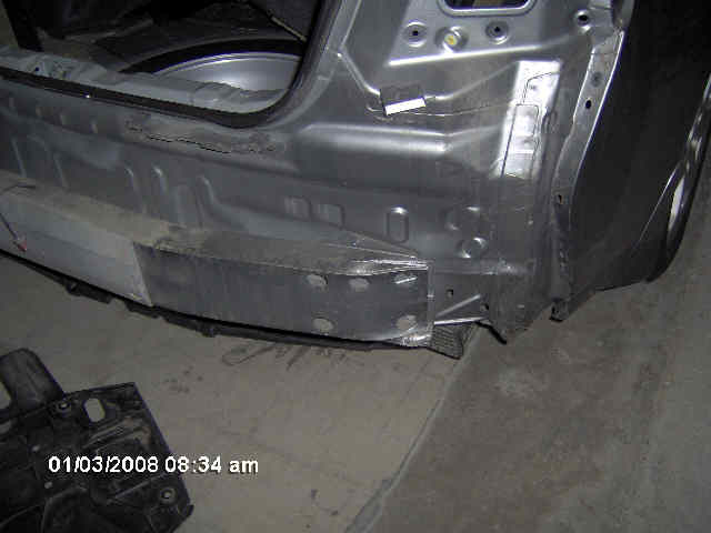

The rear passenger side frame was bent and they pulled it rather than totalling it. I'm honestly not going to feel safe getting back into that car unless the mechanic can tell me why the car jerked to the side twice resulting in a violent spin out. Also after the accident the entire interior of the car frosted over on a cold night. Heres two pictures.. one of the rear passenger side damage with bumper on and with it off
Attached Thumbnails Help me please.. Crashed G35x... have questions-337010851_p_6.jpg   Help me please.. Crashed G35x... have questions-337499549_p_3.jpg

Ouch, sorry to hear about that but good thing you are OK from the accident. Did you take the car back to the same dealer where you purchased for damage estimate? It sounds like the same thing I went through before with my previous car (Lexus). It was a not-at-fault front-side collision. Took the car back to the dealer to get the damages repaired on the other party's insurance bill. There was obvious frame damage but for whatever odd reason the dealer decided to pull back the damaged frame into normal shape instead of replacing the frame parts. This is clearly one example of what a dealer or body shop would do to cut corners and preserve costs and headaches when repairing damaged vehicles, and it sounds like you're going through the same scenario. You should go back to the dealer and convince them that the car will not drive the same with the damaged frame still in place. Also, it would be a good idea to bring up the issue of the airbags not being deployed when they're supposed to in the event of an accident.
